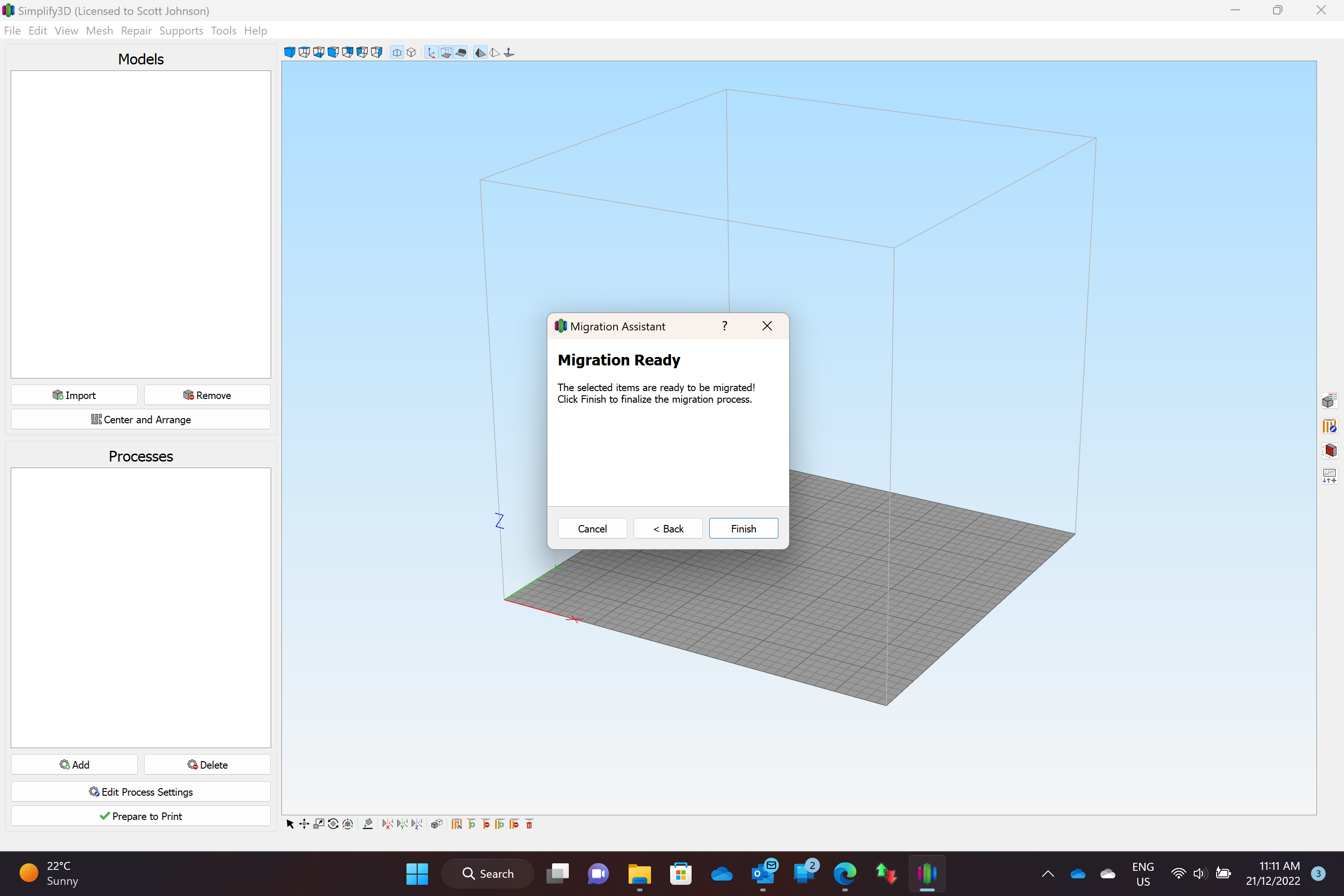

Hi all,
Just upgraded to V5. Tried the migration assistant tool, no luck. didn't even show what it was wanting to import

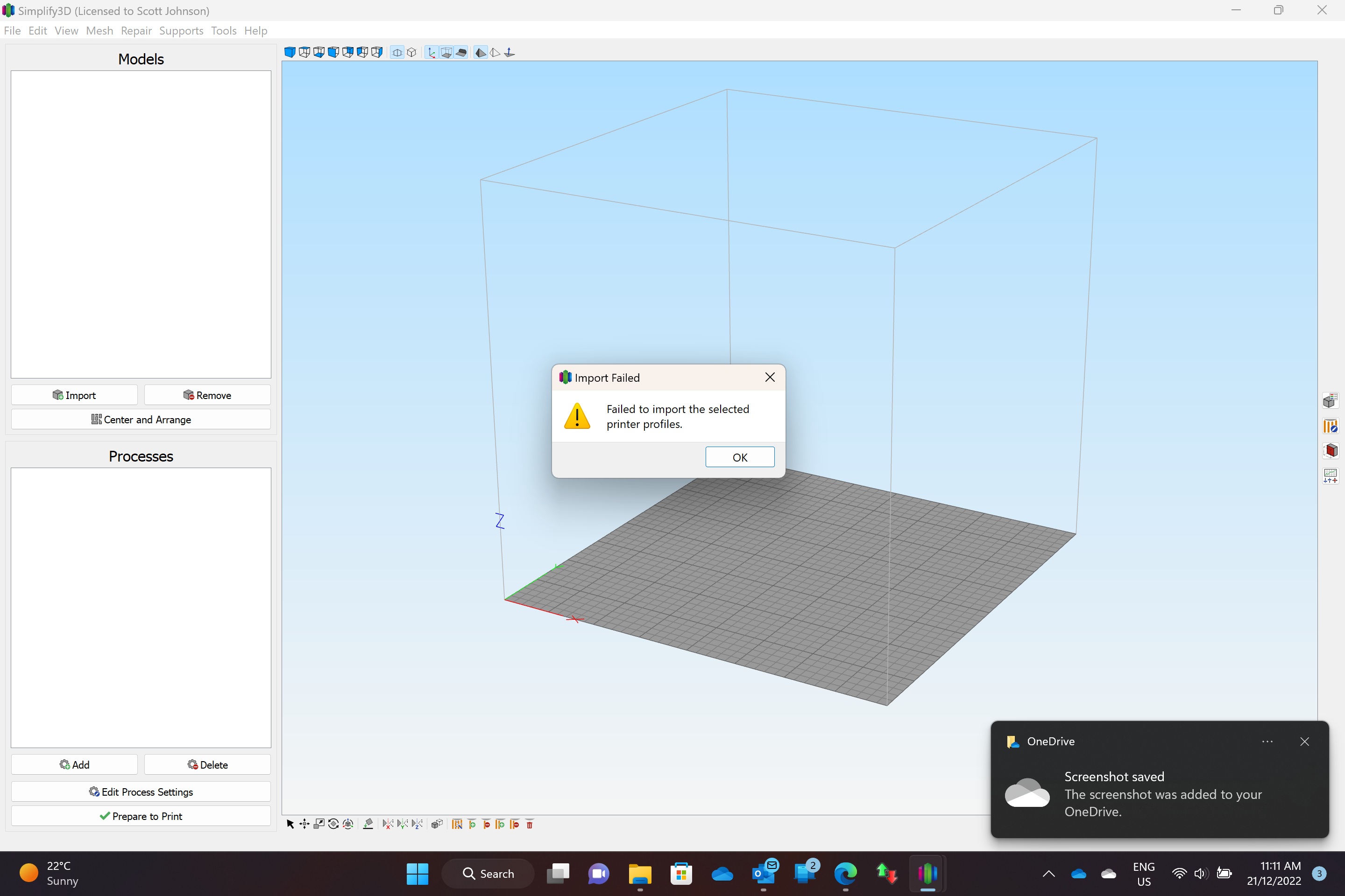

I tried import printer profile. That failed

What am i doing wrong
Re: V5 FFF import issue from V4.1.2
I would guess it's the same problem and solution as what is posted here:
viewtopic.php?p=63002#p63002
SJI
Joined: Fri Dec 04, 2015 4:57 am
i couldn't see any issues described in the link. all look ok to me
I just wanted to mention that V5.0.1 was released this will with some improved logic for importing old V4 profiles that may have some minor errors in the XML. The profile in the first post now imports correctly in this latest 5.0.1 version, so if you update to the new software the problem should be fixed!
