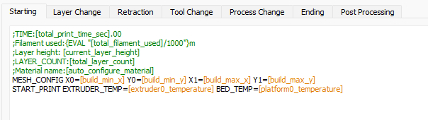

can someone please explain how I can get this syntax "MESH_CONFIG X0=[build_min_x] Y0=[build_min_y] X1=[build_max_x] Y1=[build_max_y] " to work with Simplify3d v5 and the K1 and K1 Max?
I have KAMP already installed, but when I insert the syntax to the starting script in S3D, the only thing that happens is, that the bed leveling is done by measuring the outer 4 corners of the printer's bed. I also noticed, that even without this syntax, but with KAMP installed, only the 4 outer corners are measured. By uninstalling KAMP all 25 points on the bed are measured.
Hope someone can help me setting this up.
Attached is a screenshot of the starting scrip with the syntax.
Best regards!
