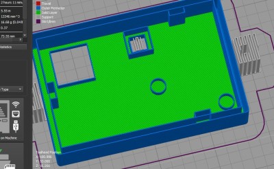

FWIW, I do not believe it is a specific file issue. If it is a program setting, I surely can't locate it.
ANY .STL file I open with the new version shows it without infill.

Rotated in Z a couple of degrees in both directions, multiple times.
Top and bottom layers set to 0
Infill set to 0 (not sure why this was recommended)
same results, obviously this "work around" did not work. How about a solution from the software guys?

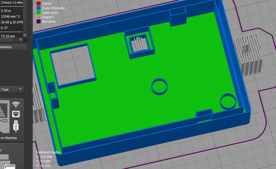

I got a response from support:
" In this file, Single outline Corkscrew printing mode (vase mode) is checked, causing infill to be disabled. "
Unchecking that (not sure why it was checked) cure the issue, I will need to look deeper when I get home and can be at the PC.

Yes cork screw is one.
and many more. have no outlines perimeters. no infill no top layers. your extrusion multiplier is really high for some reason is set at 1.40 right now.
posted your factory file with a few changes.
also set the extrusion multiplier to 1.00
every thing appears to slice fine. Happy printing!
