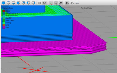

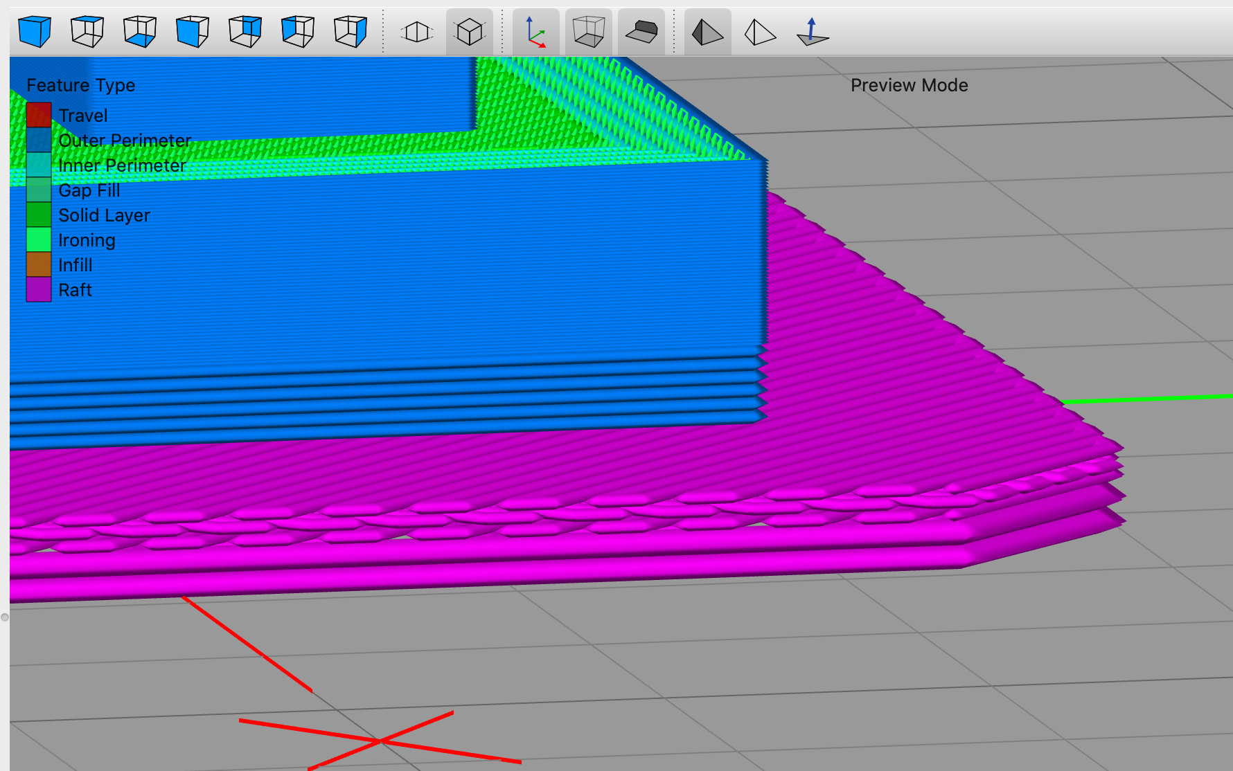

LGGreen
Posts: 19
Joined: Thu Jan 18, 2018 1:58 pm
Re: V5 Raft top infill
I am also finding it difficult to produce a decent raft with version 5. I am trying your method. So far I have a decent raft but the second process where the model is being printed has 5 layers at the layer height of the first process followed by layers at the correct height for the process. My raft is two base layers plus three top layers for now. If I reduce the raft layers to three then the first three layers of the second process are at the process one layer height, Any ideas?
