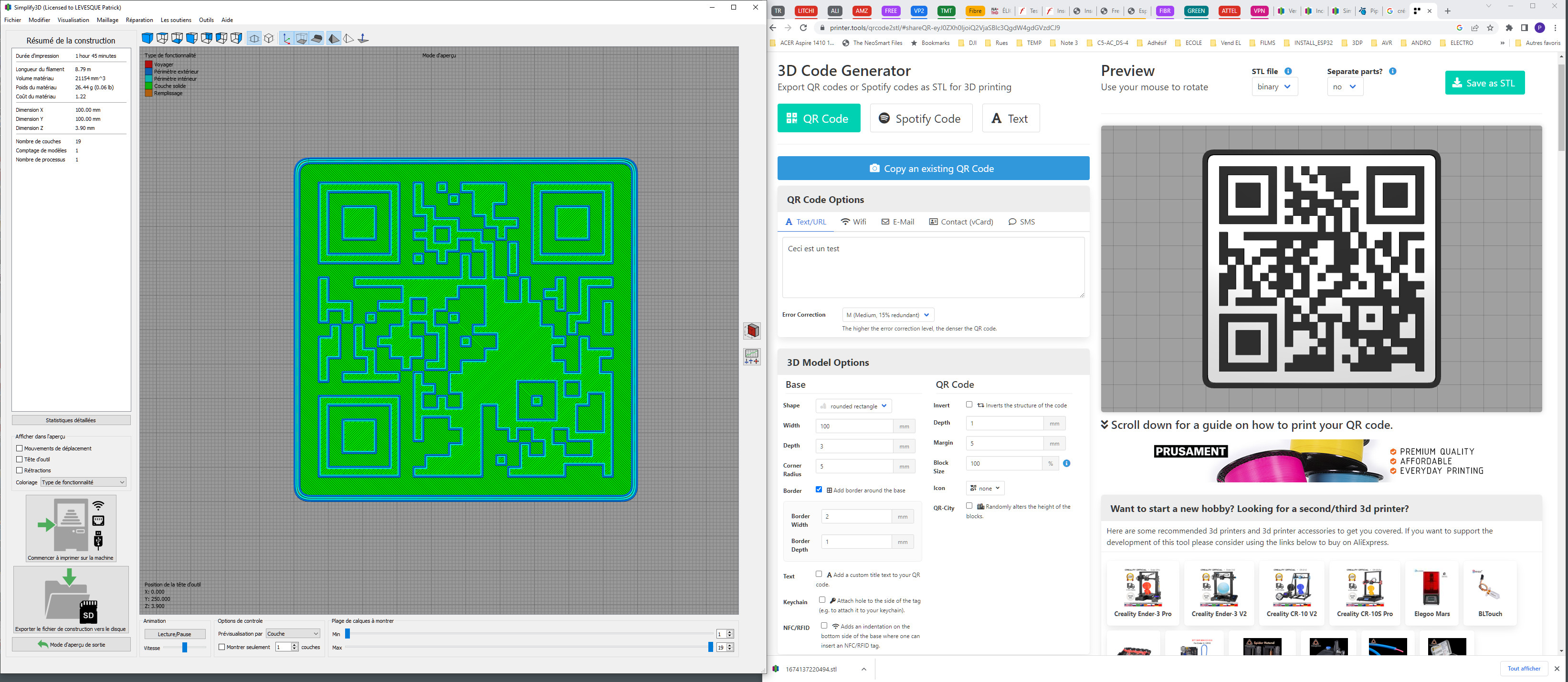

Re: Incorrect Slicing in V5.0
Thanks for your help, but that's not help I'm looking for...
This is an update to make it work like before !
I've been doing QR-codes for years...
Even with online software, V5 does not work properly.

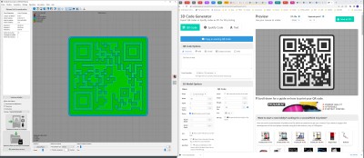

5.0 worked fine for me but since 5.0.1 I have a slicing issue: viewtopic.php?t=16923
The original STL file in this thread sliced correctly in V5.0.1 for me. Go to Edit Process Settings > Advanced tab, and change the Slicing Region Repair Mode to "Alternating Fill". That seems to work better with this model.
PatrickLevesque
Posts: 15
Joined: Sun Jan 01, 2023 11:13 am
Hello S3D-Jason,
Indeed it now works with this new option !
Thank you for helping me !
