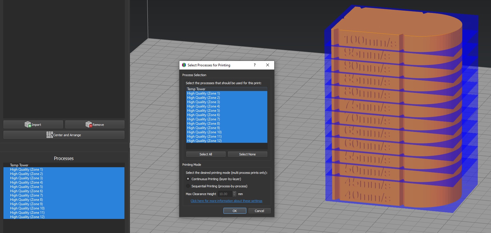

I was doing a speed tower that changes every 5mm in height. The tower covers 40mm/s to 100mm/s, so I made 11 processes to change the speed from 45mm/s to 100mm/s. I selected "Prepare to print" > "Continuous Printing" > "OK" and the software crashes around 50%.
Well, while I was writing this to give a better description, I found a work around. If I don't have all the processes selected within the Process column (I would have Zone 1 selected only) then selecting 'Prepare to Print' would open the process window where I would then select all process zones. This will cause the software to crash, you must have all processes selected before and after.
I was following the instructions here: https://www.simplify3d.com/resources/ar ... f-a-model/
where it doesn't call this out, so I will assume its a bug?

Repeatable: Yes (Case 3)
Save Factory File: Yes
More findings:
Case 1
If I keep the Zone count low, around 4 zones is what I tried. I select one zone in the process column and all the zones in the prepare to print window and it seems to work fine.
Case 2
I made 10 zones (no changes between zone configs) and the software generated an 11th zone for some reason. Then the print option wouldn't work until I noticed the 11th zone and deselected it. Then the slicer worked fine.
Never seen this until now:
I selected new "File" to have a fresh start and selected 'Discard' option in the thoughts this would open a new window but the software closed and never opened a new project. I had to re-select the Simplify3D shortcut to get a new project opened.
Case 3 - Can repeat this crash 2x
I made 12 zones, each zone config had the speed change from 45, 50, 55, 60, 65, etc... and only selected 2 processes under the column Zone 3 and Zone 4. Then the window after Prepare to print I selected all zones. This made the software crash, this is what it said along the bottom right when it crashes "Looking for over hangs" status bar is about 45 - 50% filled
