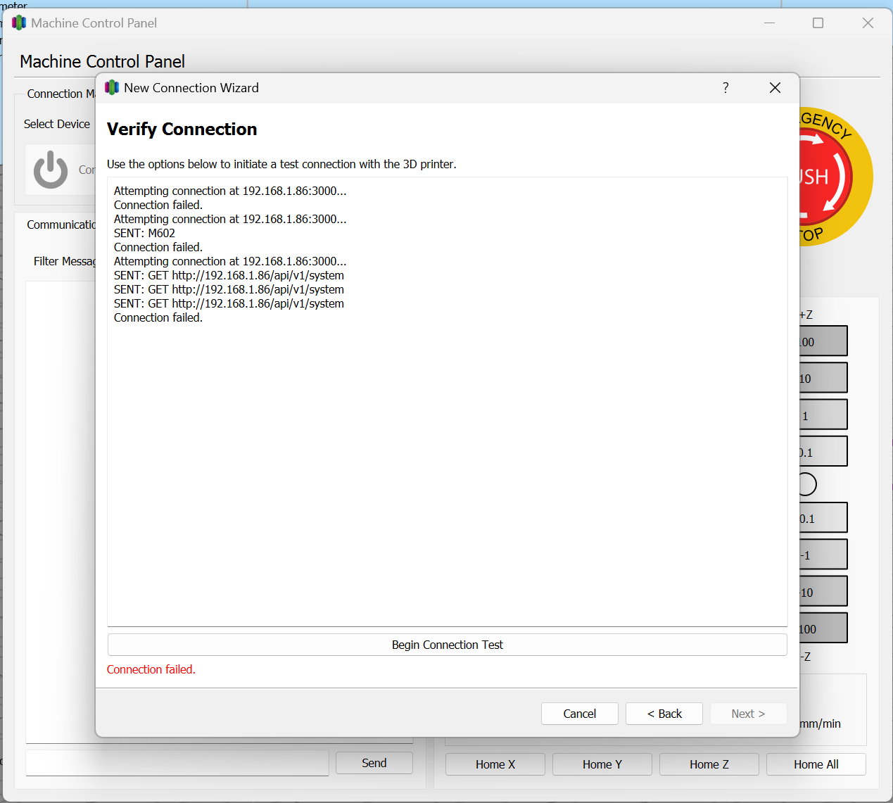

I can connect to Bambulab X1C "LAN Only" mode via FTP. I am currently using FileZilla to FTP GCODE created in Simplify3D. Create GCode, save to folder, drag and drop in FileZilla or send with FTP command in Terminal (if FTP commands installed).
Simplfy3D Connection works up to the username and password. Simplify3D software v 5 is not configured to ask for the username and password. I attempted to use username:password@bambulabx2ipaddress:21 but again, Simplify3D software is not configured to accept this information and connect to the machine.
FTP access to Bambulab x1 in LAN Only mode, username bblp, password is 8 digit number located on Lan Only dialogue box on X1
Port 21 is open.

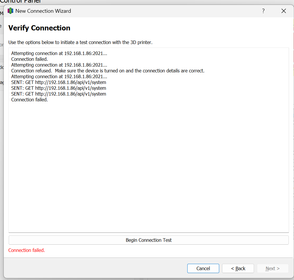

Running firmware 01.03.00.00
I am also able to connect via FTP w/o putting the X1 in Lan only mode.
Tried a few other ports from Win11 to Bambulab. 2021, 3000, 8881 with slightly different dialogues responses, all fail.
