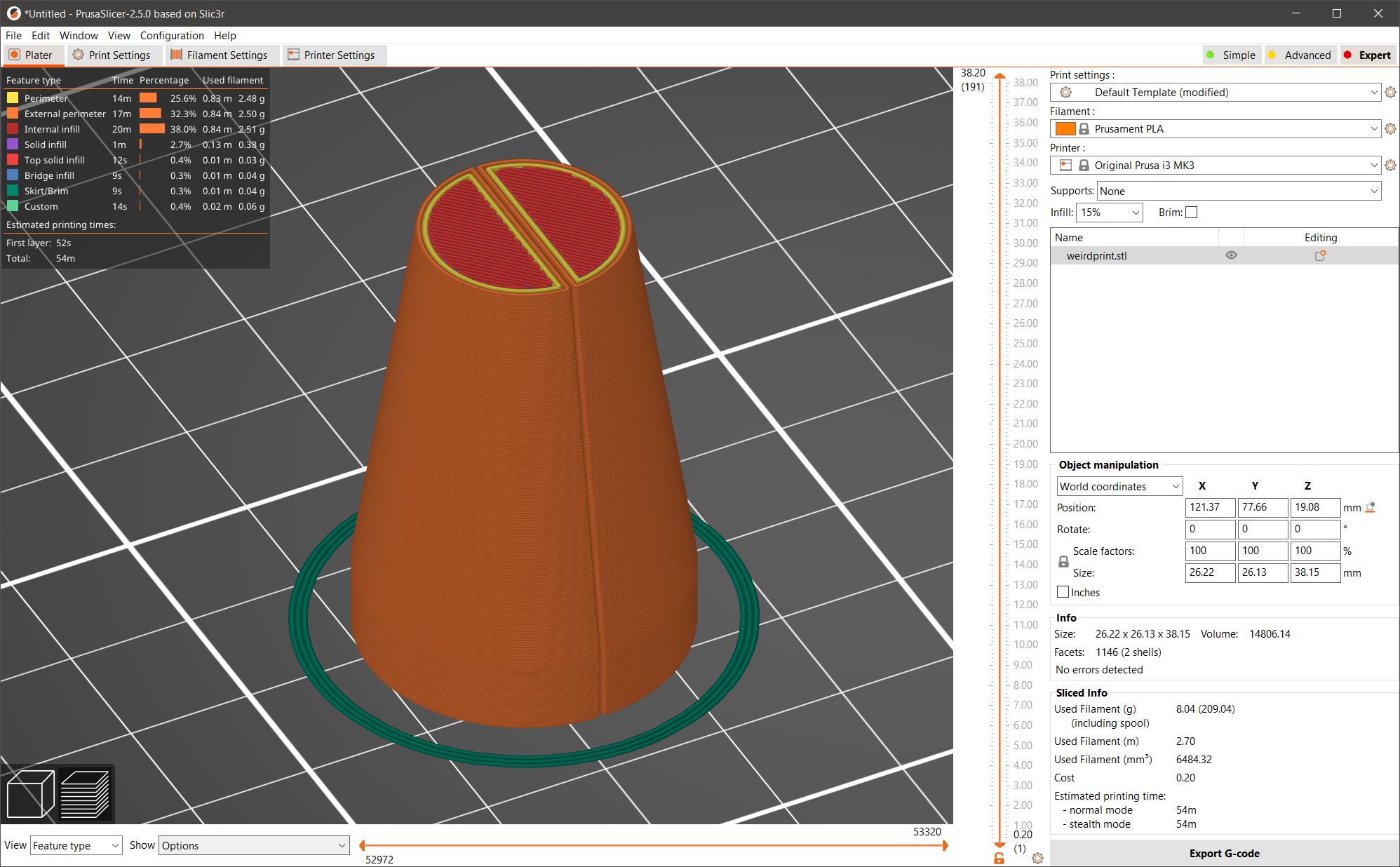

bolsoncerrado wrote: ↑Mon Feb 06, 2023 7:50 am Here's the "offending" file...
Hmm... 2 shells with 0 distance? This looks like something they've introduced with 4.1.1...

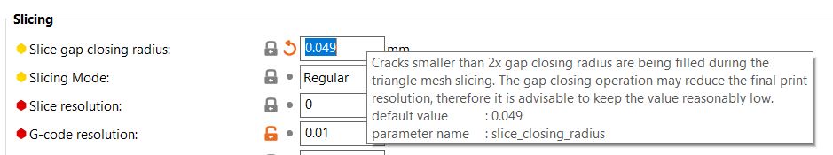

It does slice in your case because you likely have the default setting for slicing gap radius set
to something > 0.
Using defaults does work:
...but only because PS is now completely ignoring the "zero space" gap between your parts where two parts end.

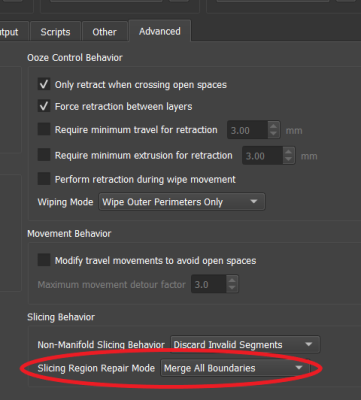

Under the advanced tab, try changing the Slicing Region Repair mode to Merge all Boundaries.

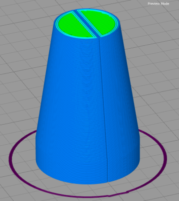

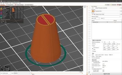

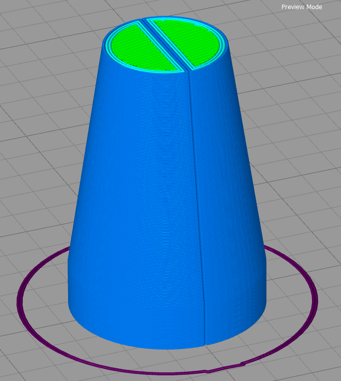

Using the provided STL, It does slice correctly.
The key is to change the following setting in the "Advanced" tab.
Not intuitive, I know. It's a setting that most of us don't use very often.
D.

That's not really what he wants. He wants it to be printed with the outer shell only, like he's
shown in PS:
The halves merged inside the STL aren't merged properly, that's what's causing these troubles.
If what he has shown in PS is what he wants the "2 shells" indicator should've already raised
an eyebrow.

parallyze wrote: ↑Mon Feb 06, 2023 7:47 pm
shown in PS:
I can't get this model to print that way in V 4 as well. Curious what his settings in V4 are that allow him to do that.
