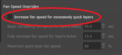

billyd wrote: ↑Mon Feb 06, 2023 8:19 pm I understand that but it's setting the fan speed to a non-zero number and it should be setting it to zero as the initial layers are set up for no cooling fan. It's setting it to S153 instead of S0 and I have no idea where it's getting that number.
I had a quick peek at your GCODE file and saw "M106 S153 P0" @ line # 261 as you'd described so then I took a look at
your .factory file and noticed that you have your fan speed overrides set.
Turning off the Fan Speed overrides eliminates the non-zero value that you're seeing (that value is calculated by S3D v5 when
slicing the model and generating the GCODE).
Line # 261 in your GCODE file will now read "M106 S0 P0" as you initially wanted it.
Hope this helps,
D.
