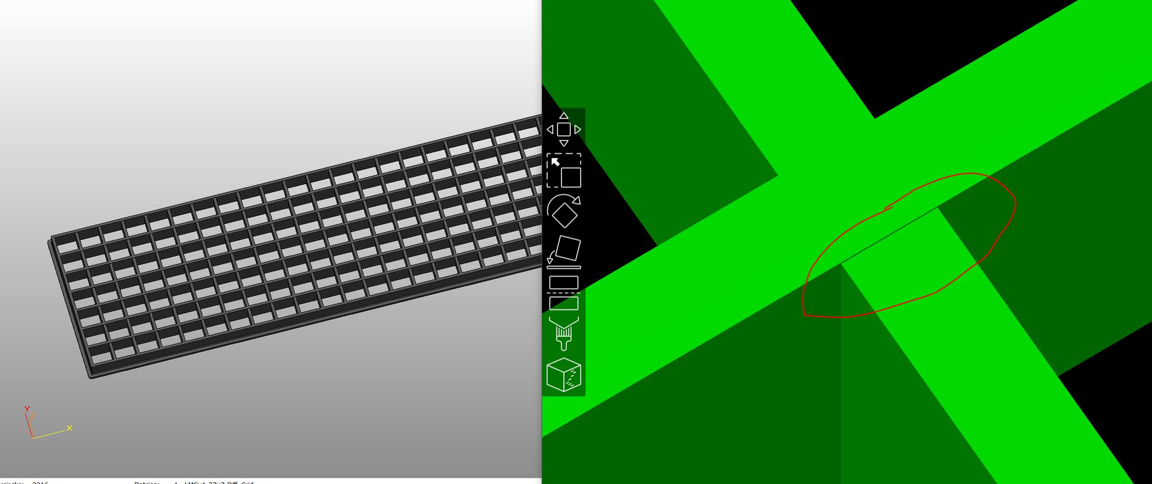

Here... this is a very simple part:
A 27x7 grid. Because there's no relevant forces applied later on I did cut the cells "open" using a
very thin 0.01mm cut.
This is what S3D vs. PS slice using their default settings:
This is PS after setting gap radius to 0.
So you're now really trying to tell me it is better when a slicer ignores small details in a proper model
file, adding more than 4500 unnecessary retracts and a lot of travel moves...?

parallyze wrote: Fri Feb 10, 2023 7:43 am A 27x7 grid. Because there's no relevant forces applied later on I did cut the cells "open" using a
Part file attached for reference, didn't fit the 3 files limit of the previous post.
LMGv1-27x7-Diff_Grid.stl
(157.11 KiB) Downloaded 7 times
