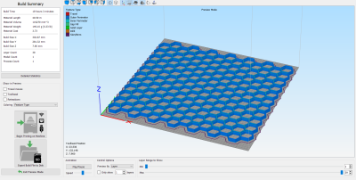

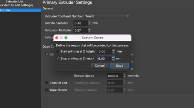

If I set the custom zone to stop at height 6mm it doesn't crash.
wall-honeycomb-293x271-(big-printer).factory
(91.06 KiB) Downloaded 156 times

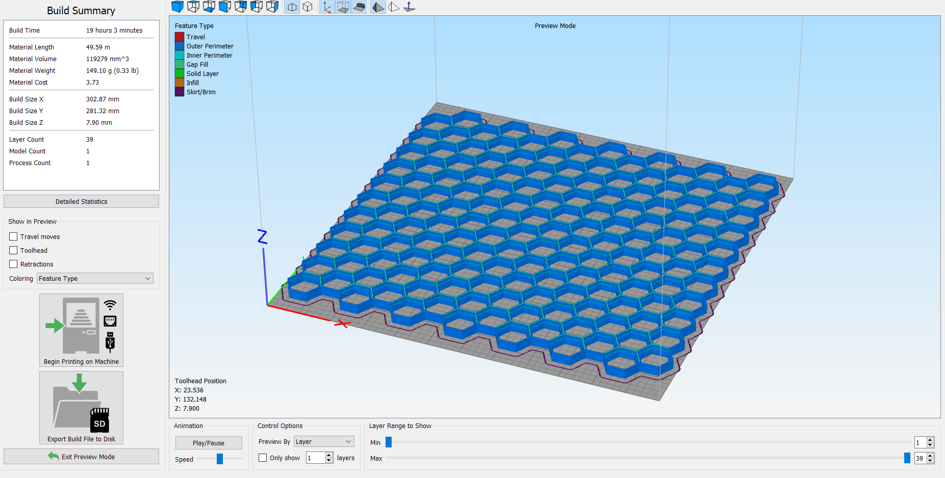

I can easily reproduce the crash on my machine with the .factory file you've provided.
Using your printer profile, I've imported other STLs, scaled them up to ridiculous sizes (filling up the full print volume) and slicing occurred without crashing. The crash only occurs when using the included model and machine settings in the .factory file.
Based on your machine's settings, I'm assuming that you're using the Vivedino Troodon (please correct me if my assumption is incorrect)
for which S3D doesn't have a built-in machine profile. So I went about and quickly created a new machine profile for it, imported your
model and using the newly created profile's default settings, sliced the model without having v5 instantly crash. See attached image
of the result.
Have you tried to recreate your machine's profile from scratch in v5? (don't use the import FFF profile feature).
Kindly let me know,
Cheers,
D.
