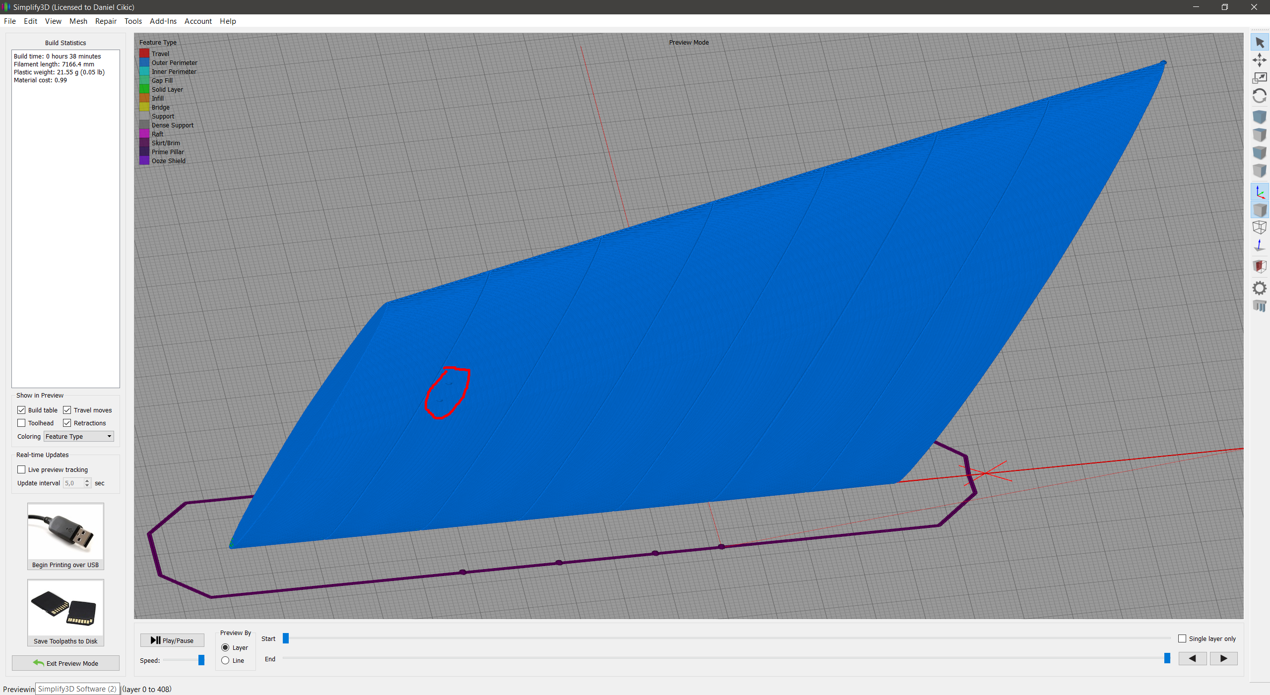

Here is the outside
See that hole on the side? that does NOT exist in any way shape or form in the model. there might be some defect but it does NOT represent "that" and here it is from the inside
See how it just erased part of the model and goes SIDEWAYS at an angle through the solid model. NOTHING is there. not like that at least.
it cropped the corner of one layer and totally bisected the next layer. this leaves either a gap or a compression in the model as it prints too high or too low as a result of the deviation from model geometry.

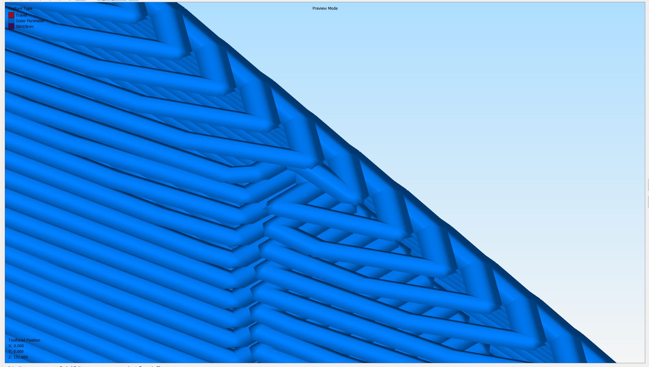

Not all the cuts are reaching the top of the model. Therefore depending on layer height and starting point of the vase mode extrusion this will cause a problem:
Depending on layer height/start position (at what height this part will be reached) S3D will try to print that tiny tip which isn't connected
any longer:
Layer Height 0.20mm:
Layer Height 0.22mm:
You might not be able to replicate using the exact same layer heights. It's dependent on the starting position, model position, orientation and things like first layer height.
When slicing the model file each slicer has to do various checks. Imagine slicing a simple box with a hole in the front. At some point you will have slices of 0.20mm height, but the one where the hole does start might be open in the upper half, closed in the lower half. As far as I can tell slicers by default tend to check the center of the slice and decide based on that if the loop is closed or not at this point...
For the example above: The tiny tip might be at 0.08mm height of a 0.20mm sliced layer and get ignored - but rotating the part might translate that point to 0.11mm inside the layer, therefore making it relevant and printed, breaking the tool path for vase mode.

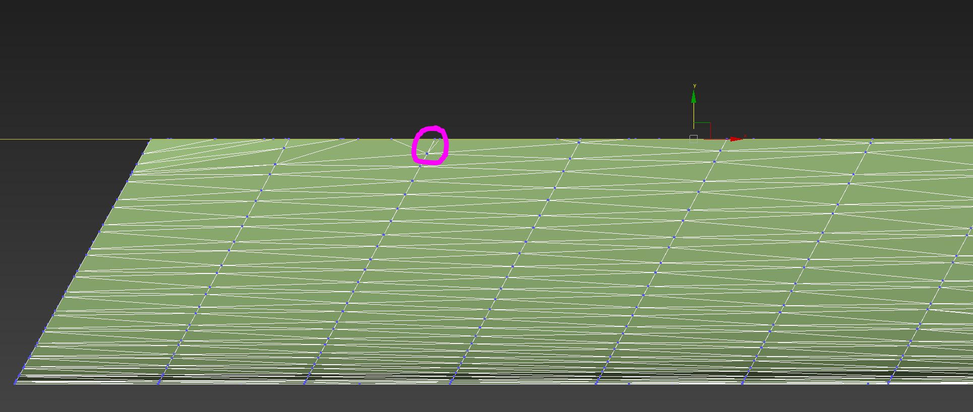

Thing is, most of the cuts aren't very straight. They are very thin and running along curves. And right now I suspect some of the vertices
being at different heights causing these problems:
Here's a close up of the cut from the second "fin" from the left:
Because the vertices of the small 0.01mm cut aren't on the same z height I suspect the "decision making" while slicing causing trouble here.
