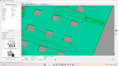

I want to print a "bar" on a printed surface.
(Image Layer_0)

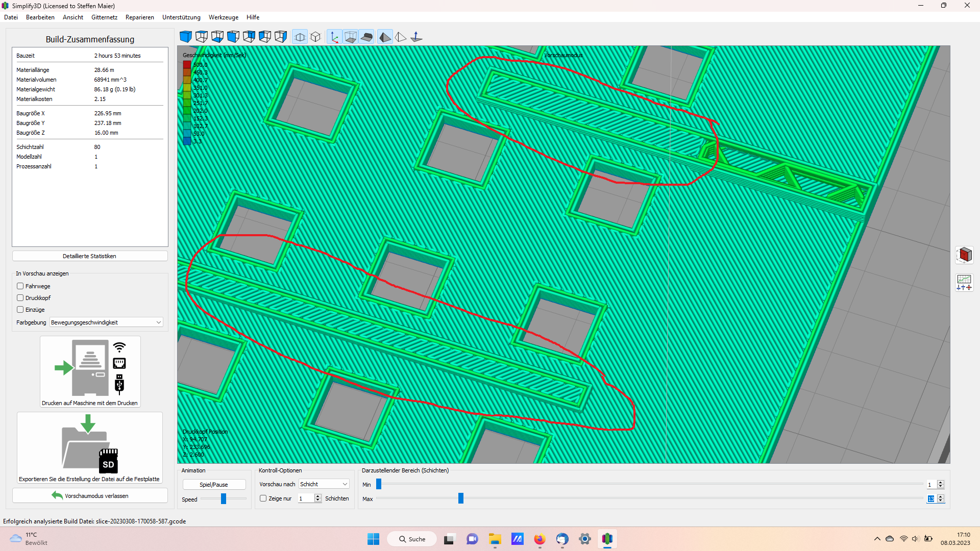

Unfortunately, the first layer of this bar is printed in strange long lines instead of filling the layer properly. (Image Layer_1)
The result is that the bar has a bad adhesion.

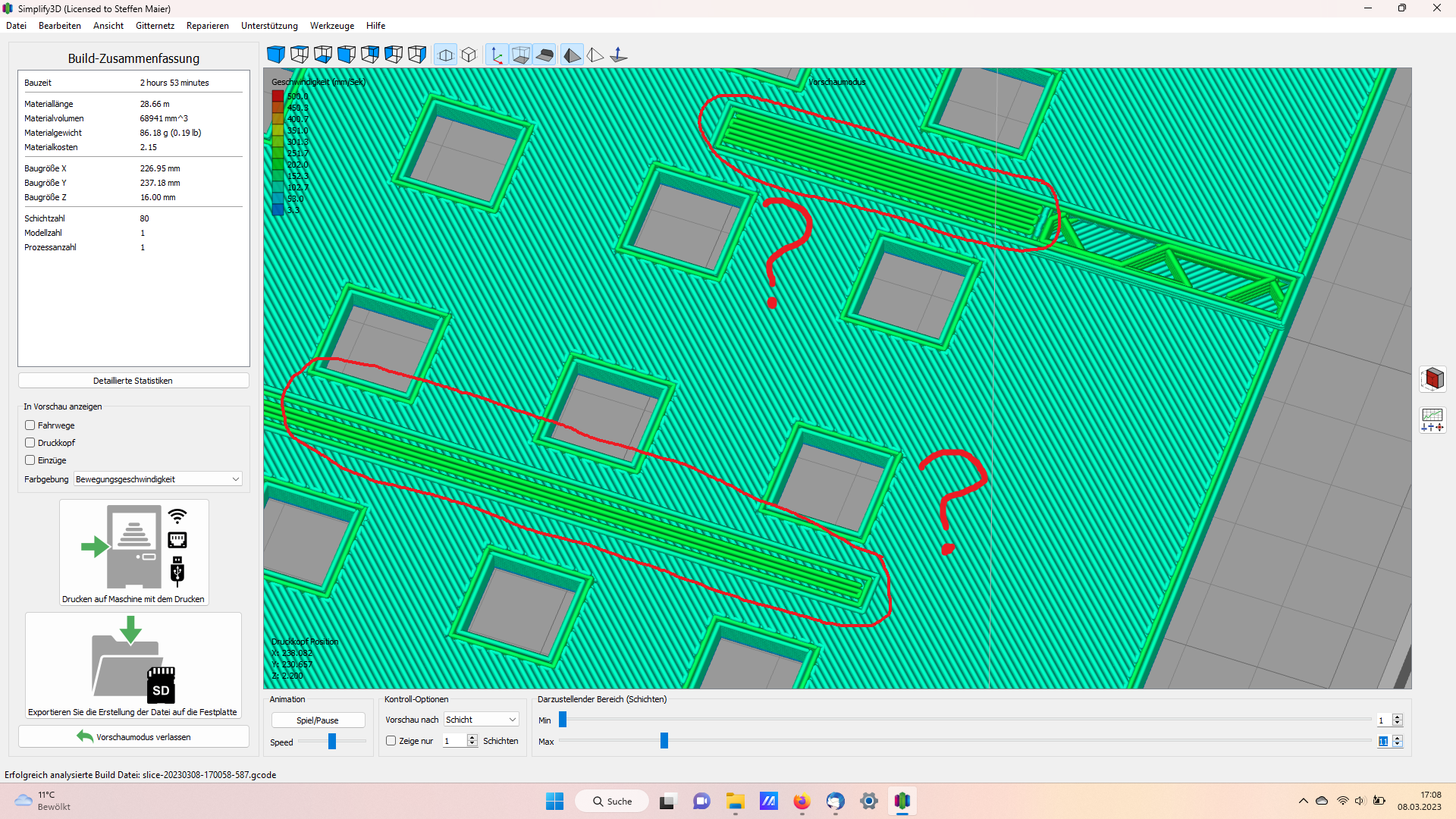

How can I get the first layer of this bar to be filled normally as in the Layer_2 image?

Re: "First layer" on already printed surface, poor adhesion
Change to the "Feature Type" coloring mode. I'm guessing those straight lines will be yellow, meaning they are bridging regions. If so, you can disable bridging by Edit Process Settings > Other tab, uncheck the "Identify Bridging Regions" setting.
Hello,
you are my hero.
That was exactly the solution.
Thank you very much!
