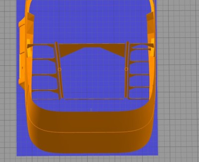

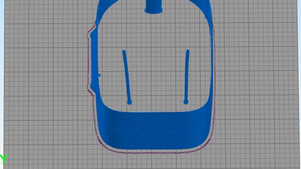

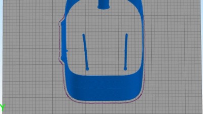

I print airplanes and used version 4 to print my B25 from 3dLabprint. or sliced. Meanwhile I have version 5.02 and wanted to slice the model again but the components are empty after slicing. I can adjust what I want, the inner strivings are missing after the slicing. The STL files are unchanged I guess there is something in the program, I can not say if it would
I attach 2 pictures to it, then you can possibly understand it better.
have worked with 5.01.
Re: in V5.02 models will slice with gaps sometimes
3DLabPrint already has instructions on their website for those models using V5:
https://3dlabprint.com/faq/setting-simp ... nt-planes/
There are 2 settings changes you need to make according to their docs:
- Infill tab > Solid Infill Threshold Area = 0 mm^2
- Advanced tab > Slicing Region Repair Mode = Alternating Fill

Thanks for the link to 3dlab - that worked, even if don´t understand what happend during the updates. :oops:
