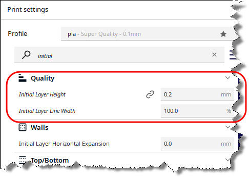

Actually I'm printing at 0.1mm layer height, I've did a check about the first layer height, in Cura I've this setting:

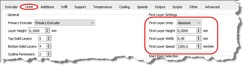

so I've use same in S3D as below:
with I think same settings with the S3D gcode I can hear sometime a click into the extrusor so I think that the height is not enough and the material was blocked, may be also a setting about the Flow?

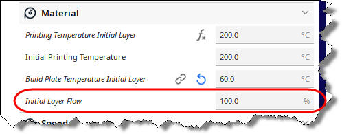

About the Flow setting in Cura I've:
so it is set to 100%, it possible to see/check this value also in S3D?
