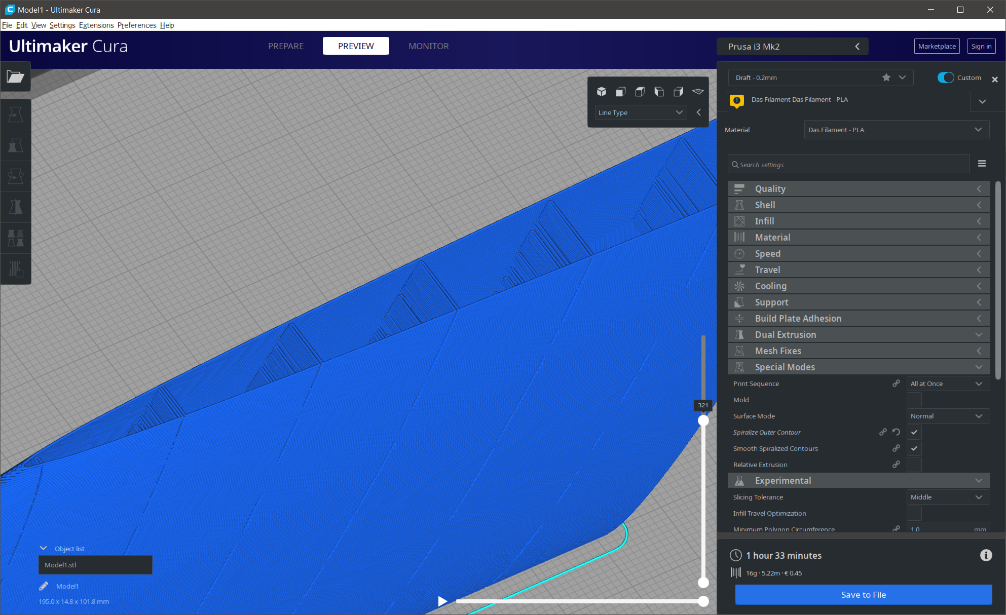

...and some last pictures to this, what Cura, PS and IdeaMaker did in comparison:
Cura 4.8.0:
Note: In Cura you can select the slicing tolerance (upper/lower/center of the layer), this
does change the slicing results. Another clue this is because of the slicing tolerances along z.

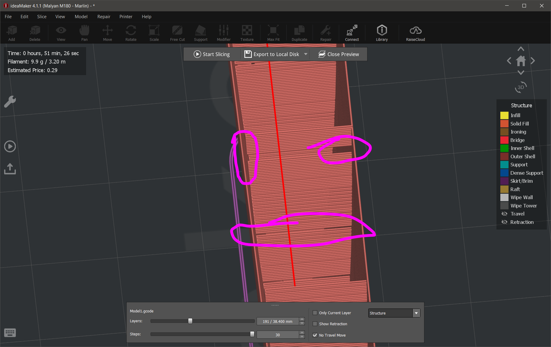

IM4.1.1:
IM4.1.1, extrusion width 0.2:
It does restore the gap to the outside - still it fails to recreate the hull, like Cura and S3D.
No, only Cura+IM. Won't make another post for the PS screenshot alone, there's not
really much to see anyways. :D

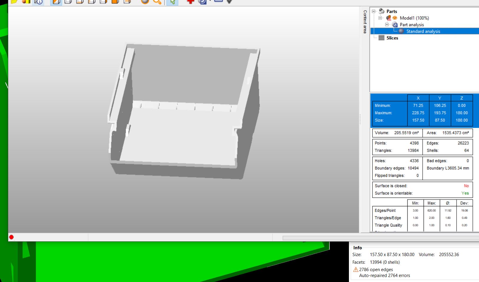

Just had a look at the stackable drawer thing, won't even start to list the errors in that file.
(Edit: I don't know why but I can't attach the image. It does show up in the attachments and is uploaded
but the "Place inline" button simply doesn't appear... o,O)
And another edit. When trying to post this I got a timeout message. So this is the last state I happened
to have in my clipboard, won't rewrite everything again.

yes that drawer is not my original work. I am just hacking it to make it more usable. it had something like 2264 errors reported and unlike normal PS can't fix them. IE normally when it corrects errors I can export the plate as STL and the corrections will be part of the export. but not that file. its a mess in a way I can't determine or understand.
Point is. the slicer is "making" glitches based on how its "handling" resolution to those issues it finds in the model. it should be consistent. if the algo changes just based on the slicer selected start point or rotation then it should do a better job at being more consistent.
I have yet to find a complex model without errors. again the issue is not whether the models have issues (of course they do) but how the slicer "behaves" when it encounters them.
