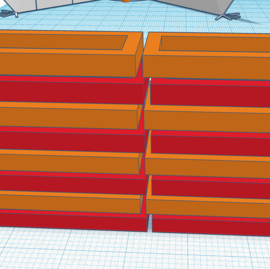

Would also love to see a way to "paint" the seam in the slicer kind of like how supports can be painted IE let me "define" hey this seam right here? overlap that.
ie shift it left one layer right the next then left then right. this way instead of a "seam" with a 0.01mm gap that is fused with over extrusion it would be a 100% solid "interlaced" deck of cards so to speak.

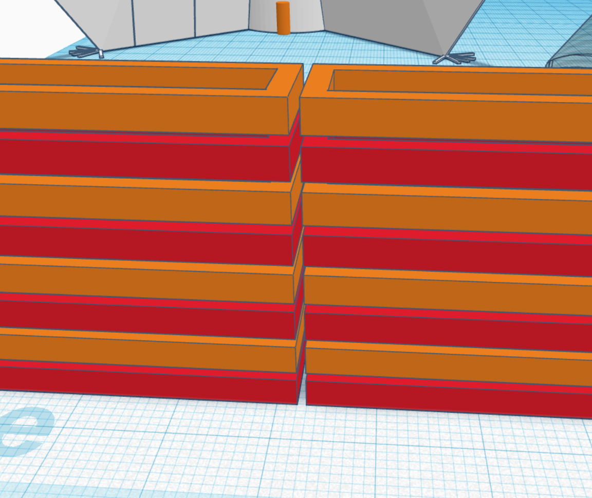

Right now when it prints the seam it looks like this (heavily exxagerated)

Instead I want it to look like this.
