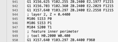

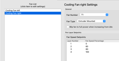

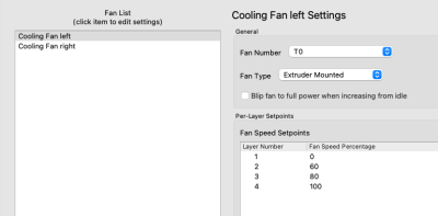

Thanks for the answer which is already in my question. I would like to know how to associate the respective tools with the corresponding fan. This is exactly what doesn't seem to work. Only both are addressed in the GCode. It is an IDEX profile with auto-configuration for extruders for each mode. Left, Right, Dual, Mirror and Copy. A GCode generated for the left extruder will automatically include the P1 fan in the GCode and not just the P0 fan as I would expect.

mehrwiedu wrote: Thu Mar 30, 2023 2:18 pm A GCode generated for the left extruder will automatically include the P1 fan in the GCode and not just the P0 fan as I would expect.
In that case, click the "..." button beside Save As New, choose "Assign settings to categories", and then search for "fan speed setpoints". You can assign that setting to the same auto-configure group that controls your extruder modes. Save the settings, then change to the left extruder configuration and remove all the set points for the P1 fan (or just include a single setpoint that turns it to zero on layer 1). Repeat as desired for the other modes.
