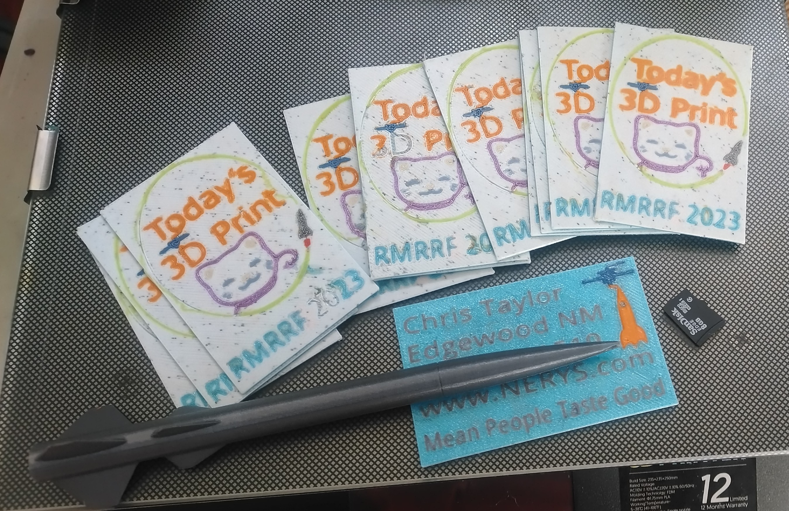

First solution won't work. I need the model separate so I can print separate STL files. (each is a different color) see picture. can't do that if I merge them.
