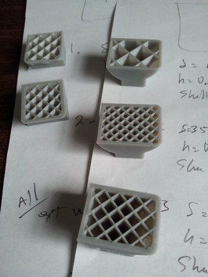

The attached small stl file part for testing your parameters - whatever part you use for testing, build a test/sample board…

Sampleboard
Sampleboard

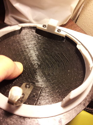

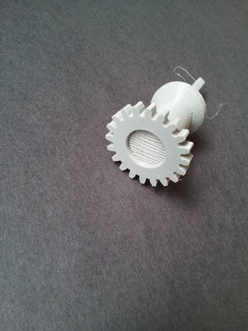

Attached photos :
The Lid has a 20deg hemisphere radius, printed withOut any supports (not even dense spts). For this part, my Harley gas tank lid, I did not care about the inside (and did not want to waste ff for supports). No loose filaments though a bit ugly but nothing hanging down, droopy/stringy - all ff is firmly bonded..
The Gear bottom is totally horizontal without supports. This is a bearing surface that rides on a small hemisphere - none of the ff is loose (though they look loose in photo but all are solidly bonded to upper infill (printed at 230 deg)
Tank Lid
Tank Lid
Gear btm view
Gear btm view
gear print
gear print
