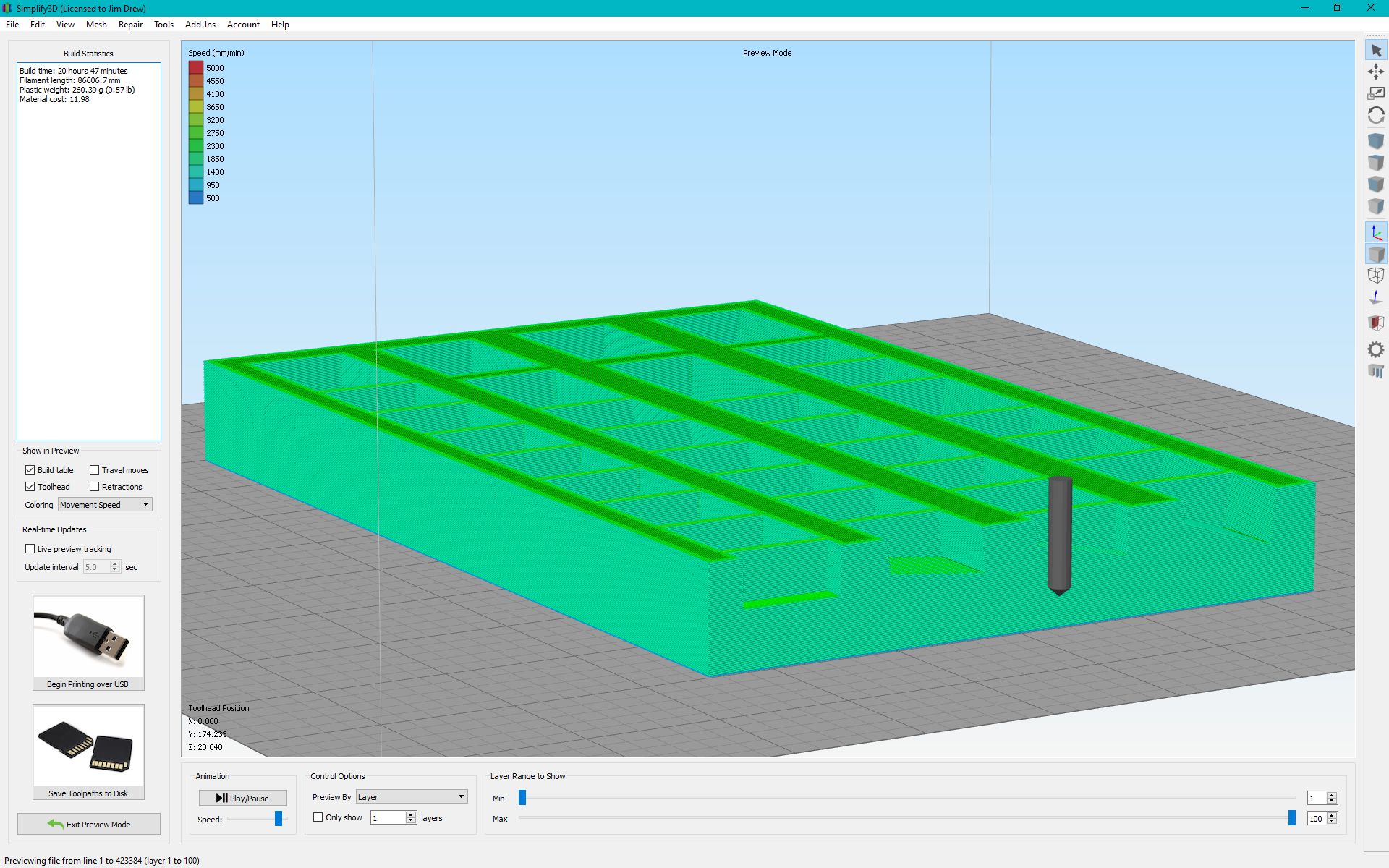

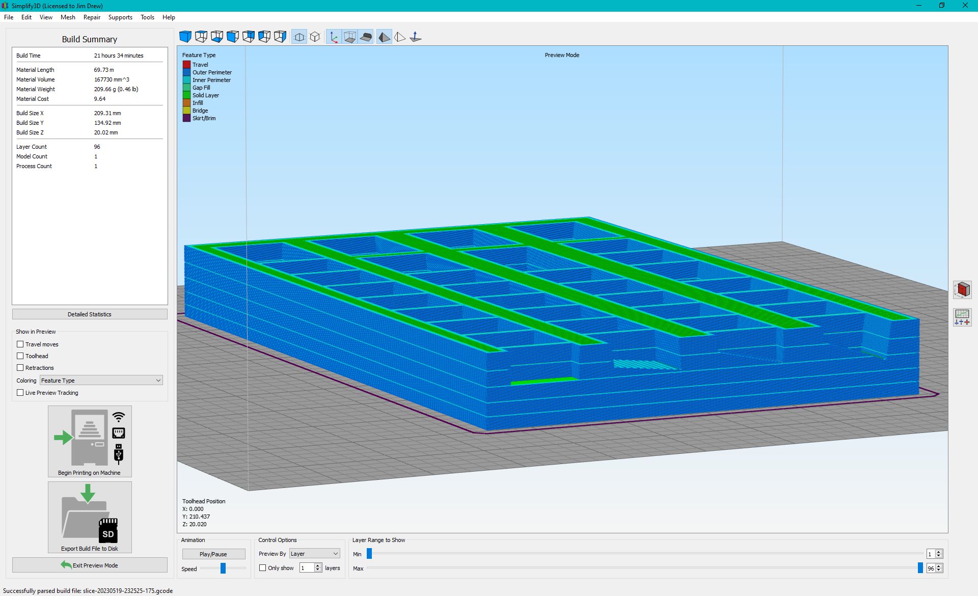

Here is the main importer, showing both halves correctly.

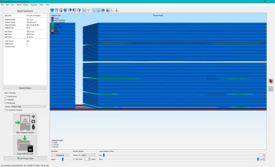

Here is a side view, showing the layers missing - clearly you can see gaps!

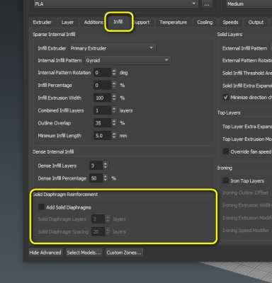

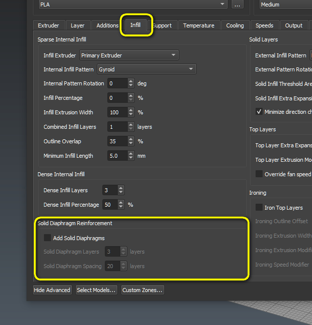

Are you sure you are not using this feature?
JimDrew
Posts: 6
Joined: Wed Oct 07, 2015 1:25 pm
Re: v5.x has missing layers
No, I am not using that feature - and I would think if I was there would be fully solid layers shown. When using the slider bar to look at the simulation of the layers being extruded, the missing layers are physically gone, as in blank and process "skips" the entire layer (jumps between the current and the next layer after the missing layer).
Also, after making a small change to the model and doing the same split with 3D Builder, I now see only 5 layers that are missing, and the location is not neat like the first example. Instead, there are two layers missing close together and then 3 more that are far away and not evenly spaced.
