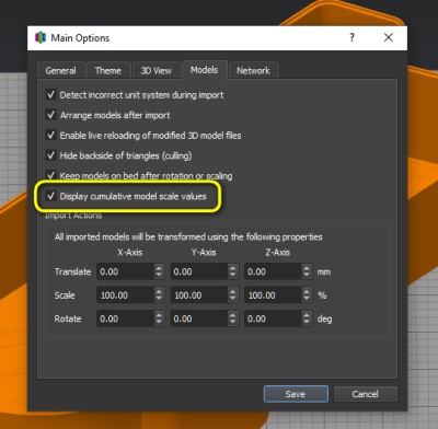

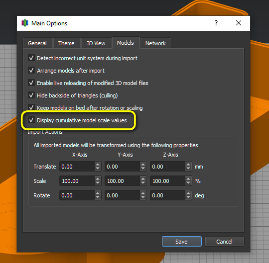

Re: Model Transform Values not retained when changed
you need to check this option.
However doesnt work with rotation
