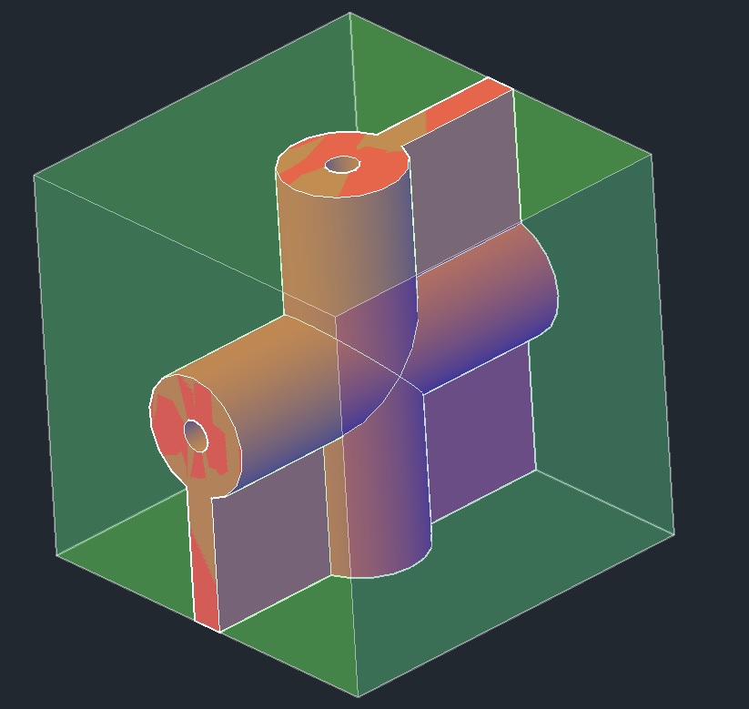

just a sample drawing to clarify the request.
The green cube is printed with a low infill, the red part with a higher infill

Slic3R does something like this.
but as you are showing here I do somewhat the same thing with the two model just assign a different process to each. Usually when I want to tap thread on a hole when I don't want a bunch of extra walls everywhere else.
like this...
https://manual.slic3r.org/advanced/modifier-mesh

the procedure chosen by slic3 is clearly more limited than the one I proposed.
As you can see from the example that I have published, the proposed method allows to define a complex resistant structure inside the object and is not limited to the definition of a "zone".
the screw example is just one example, the simplest I could describe.
however the example that you linked is significant of the problems that can be encountered during the design of a structural part to be built with a 3d printer, different areas of the object are subject to different forces that must be appropriately managed
