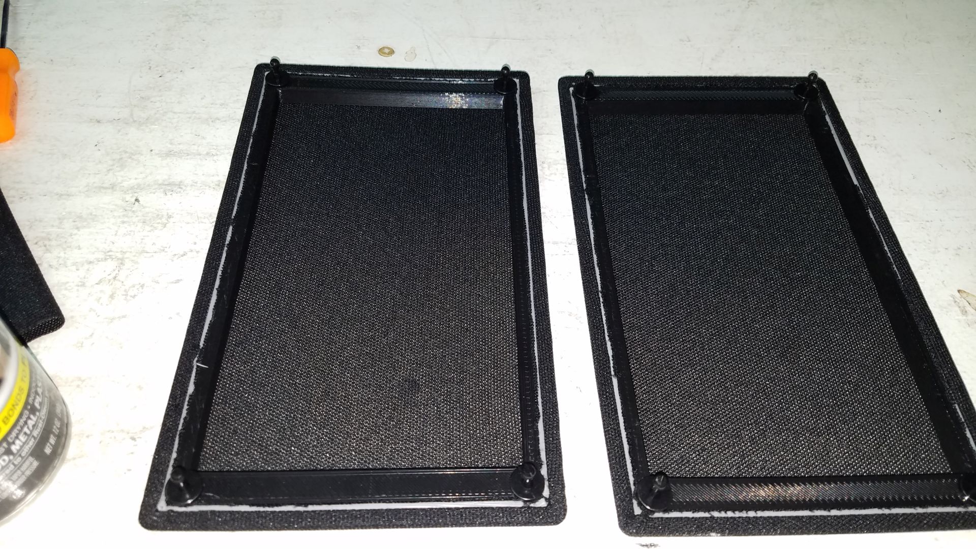

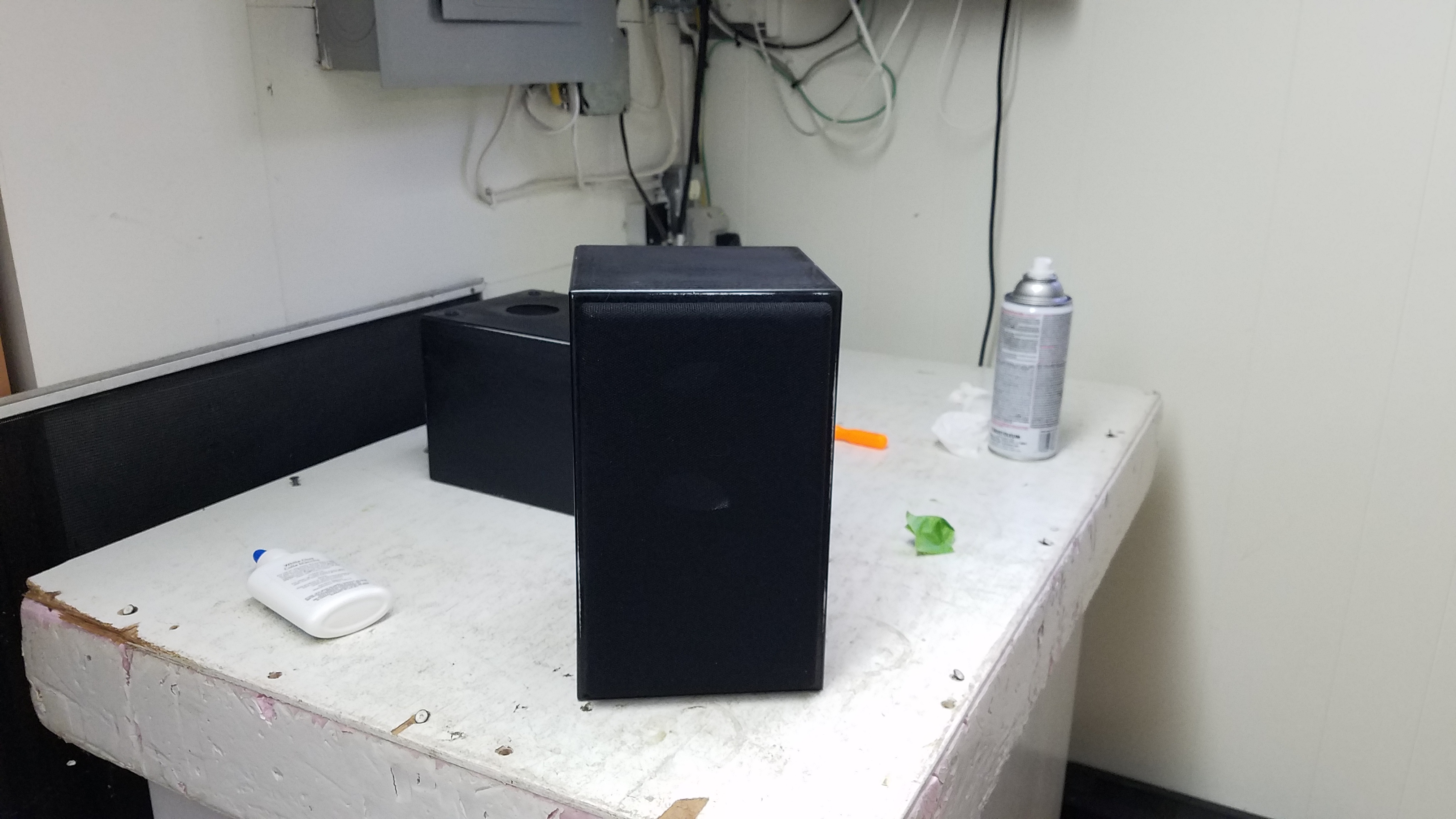

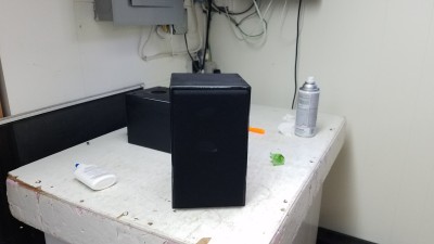

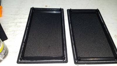

not sure what this is for but if for a small bookshelf speaker system, you may want to consider printing a grill frame and wrapping it with speaker cloth. Did this and worked out really well using window screen spline to hold the cloth in the grill grove. I had considered doing an infill only but knew it would alter the sound.
