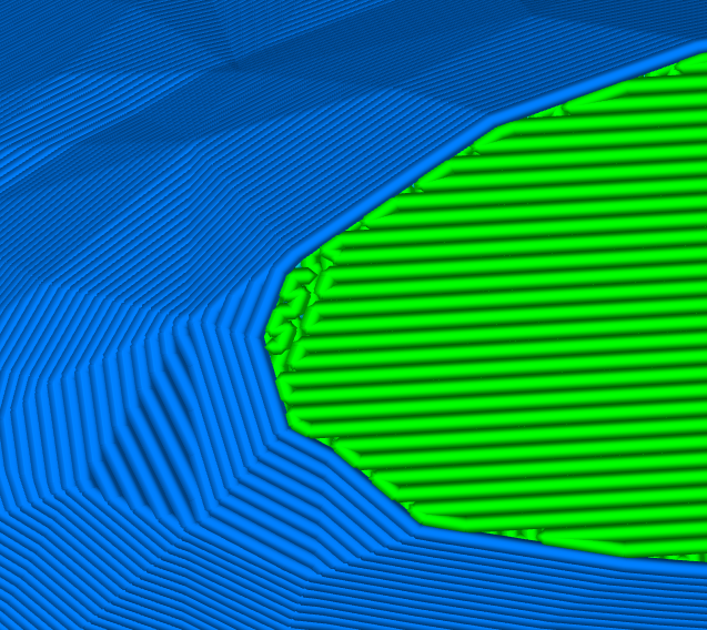

Any idea why its splitting up the layers like this?
This is guarenteed to fail. it can't work. any idea why its doing this? why its "splitting" the layer into segments for some reason?

wanted add 5.1 does this 5.0.2 does not
it should not do this but it seems something to do with when top layer shows between layers
it appears the these islands are treated as a separate thing and not merged with the internal top layer.
this is also making 5.1 unusable for me aswell!
Show stopper bug.

the green areas next to each other should be meagered. This is causing excessive amounts of travel reversing for top layer infill and slowing down the prints. slicing in 5.02 does not exhibit this behavior. oddly if you flip the part over and set bottom layer to 8 it does not show this problem only top layer have this issue.

If you change the preview coloring to movement speed, you will see why those regions are printed differently. For example, in the 2nd screenshot a portion of that big rectangle is exposed as a top layer, and the settings say to print top layers at 50% the speed of regular solid infill, so that section is separated and printed slower.
If you change the top layer speed to 100% so that the entire solid layer can be printed at the same speed, then the entire region is printed at once.

I can certainly share that feedback with the team, but I did confirm that this is the intended behavior for the software. It is performing as designed. If you use different settings for the top layer (speed, flow rate, spacing, etc), then those regions need to be printed separately from the regular solid fill. Otherwise you would be extruding at 200 mm/s, 100% flow, but then expected to immediately slow down to 50 mm/s and potentially 120% flow in the same movement. The flow and speed cannot change this quickly, so the solution is to print these regions separately with the exact settings that you specify.
If you do not want to print the regions separately, then the top layers cannot use different properties than the regular solid layers. So set them both to use the same speed and flow rate, then the division will go away.
