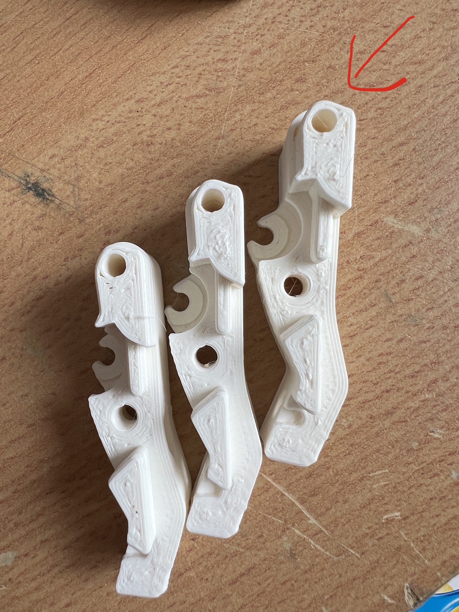

im using the newest Version from Simplify 3D for my Voron 2.4
One thing where i had problems since all years are the gaps in the perimeters. I´m using ABS white from filamentworld and a rapido hotend.
Please find attached some pictures. I don´t know which parameter is focussing on this gaps to remove this completly.

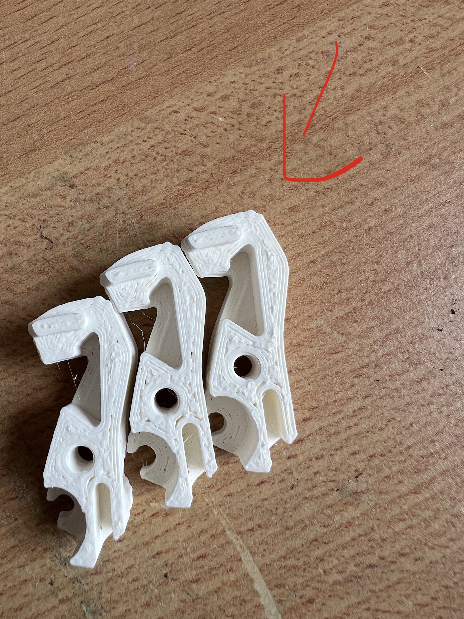

The two prints marked with the red arrow have still gaps around after changing some parameters.
I´m not sure how to export one the single FFF document. It looks like that all of my savings were export. The correct used process was "ABS (New) :mrgreen:
Do you have ideas what can be the reason for the gaps?
Thanks for your help

May want to try increasing the outline overlap percentage by another 10% or so. It also looks like there might be some extrusion issues, since the parts I've seen off our Voron 2.4 look quite a bit cleaner. Hard to tell if it's over-extrusion, or just inconsistent extrusion rates in general.
