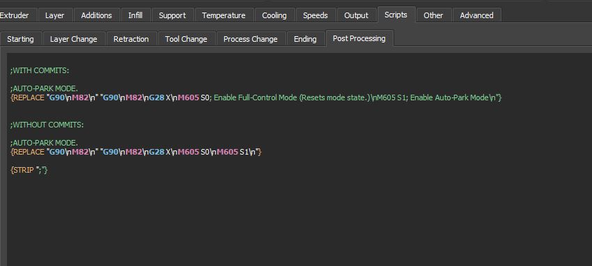

<Post-Processing BUG>
If you put his in your Post Processing it will work, but the color coding get confused when you add a commit ';' in any of the "Search" or "Replace" Strings.
<Post Processing>
;AUTO-PARK MODE.
{REPLACE "G90\nM82\n" "G90\nM82\nG28 X\nM605 S0; Enable Full-Control Mode (Resets mode state.)\nM605 S1; Enable Auto-Park Mode\n"}
</Post Processing>
Everything after \nM605 S0 is green like it is a commit, but still produces the desired outcome (See Picture Attachments).

Post-Processing BUG
Post-Processing BUG
Re: Starting Script and Post-Processing "Bugs"
For the starting script, the intended behavior is that S3D will add the temperature commands automatically at the top of the file, unless you are using the [extruder0_temperature] style variables yourself in the script. Customers usually do that when they want to precisely control when the extruders or bed is heated, so we do not add a duplicate command at the top of the file in that scenario.
