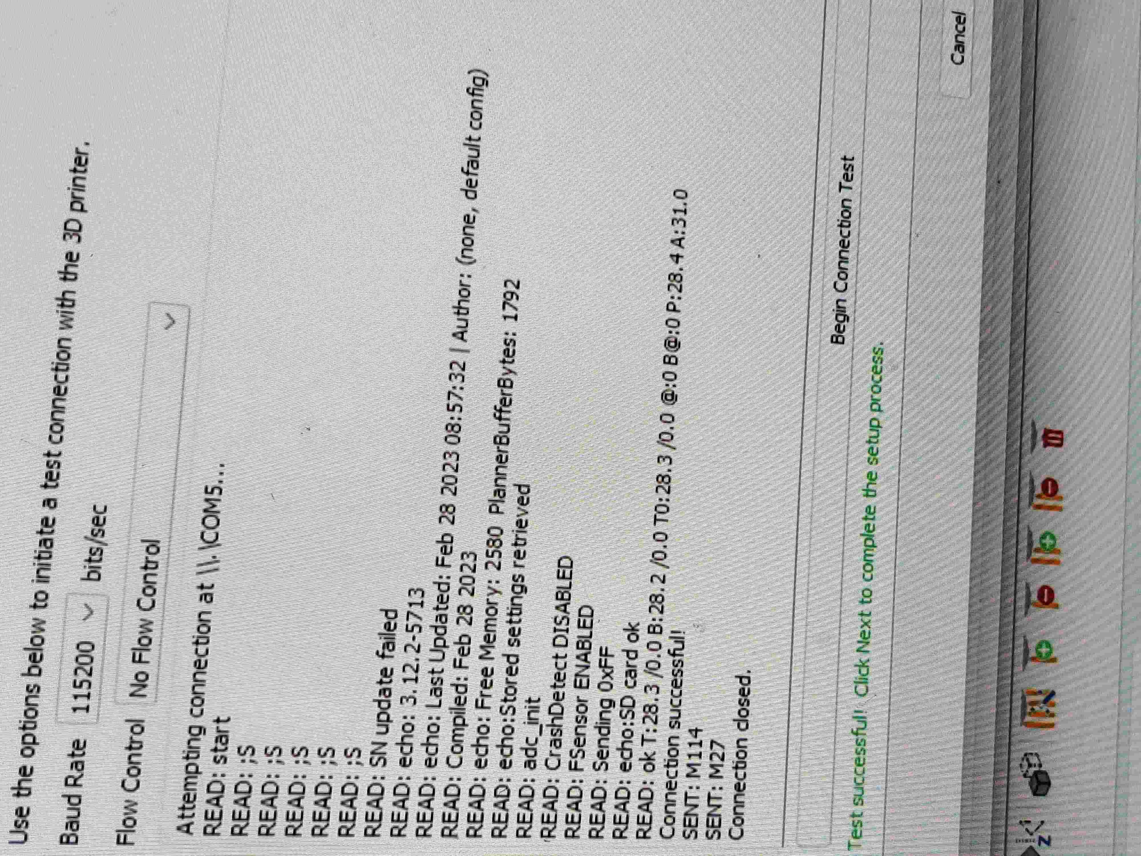

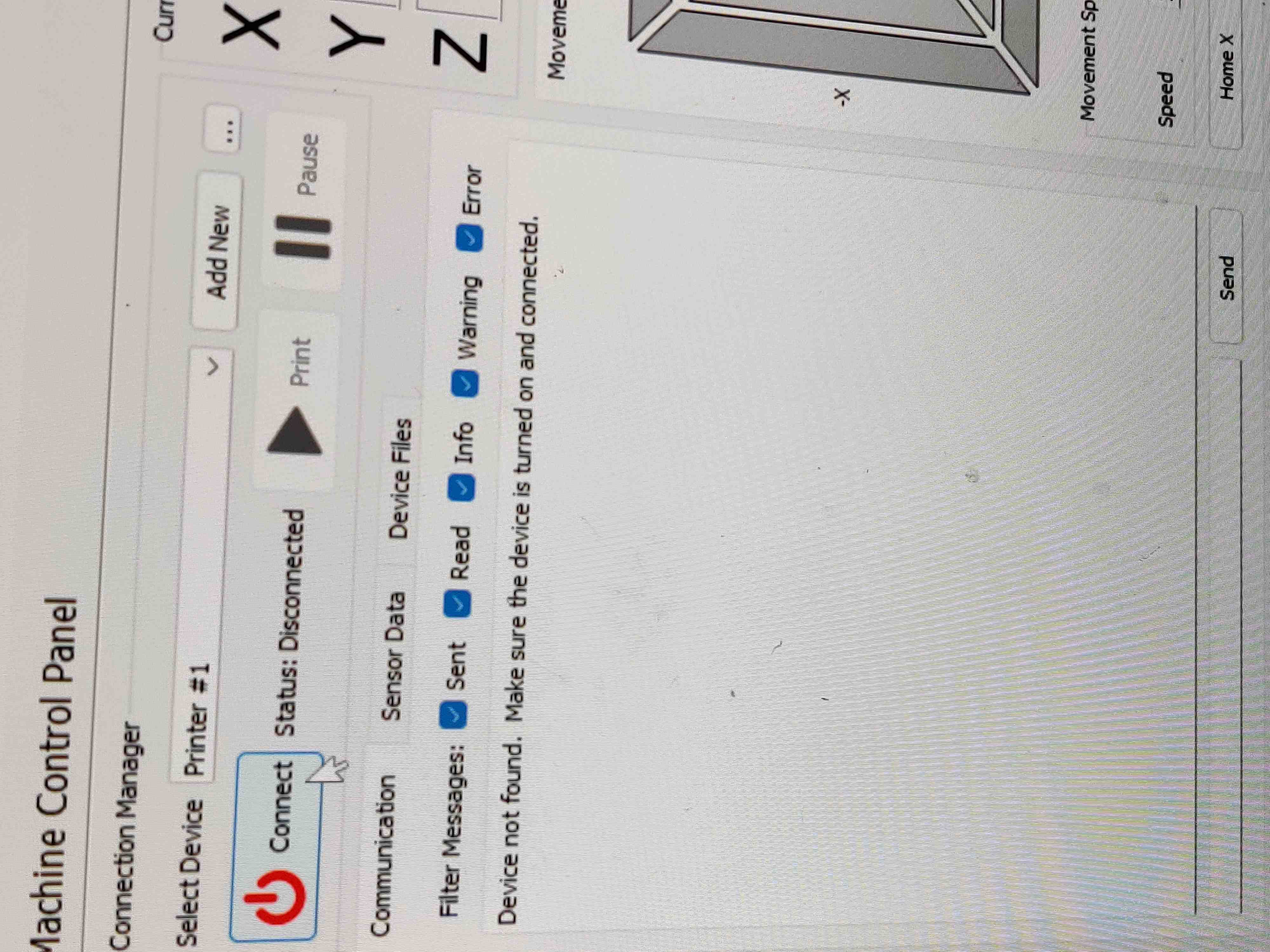

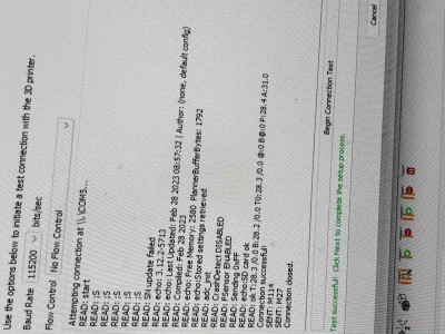

I did add new and it connect the printer on the USB port preform the connection test but after this when I press the"connect "button in the Contro; Panel i get the message

Can you attach a screenshot of the exact error you are seeing?
It would also be helpful if you could copy and paste the entire communication log that is displayed.

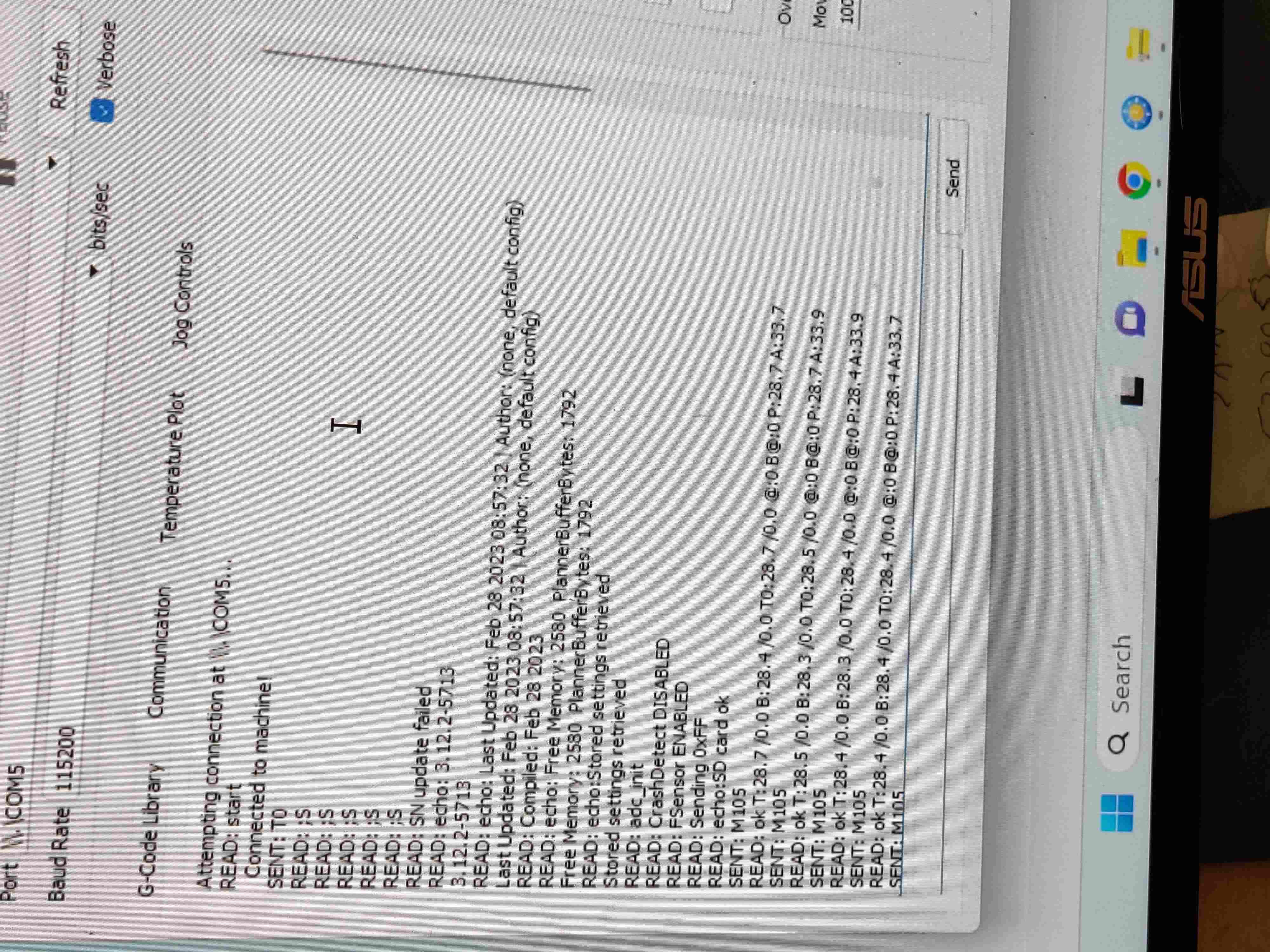

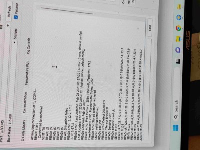

I add also pic from connect using ver 4 the some pc and printer

It looks like the wizard connected successfully, so you should hopefully have everything configured at that point.
After you exit the wizard, use the "Select Device" drop down list so choose which printer you want to connect to. In your case, the last entry in that list is probably the one you want.
