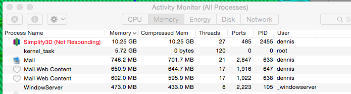

Re: Memory Leak
I have 16 gigs. I run usually 3 and sometimes 4 virtual machines at the same time. Linux, windows and mac all doing development work. Yeah.. if S3D starts taking up more than 3 or 4 gigs I notice big time. I'm not having any crashes but I do have to restart S3D regularly. I slice a lot of models so this gets annoying.

Re: Memory Leak
Well it appears over the multiple versions memory management isn't much of a priority for you guys. Sure is annoying though. Wish it would get some attention.
Instruments->memory profile...you know. Just find out where it's all going and remove your hanging refs :) :)
Really... basic stuff here ;)
