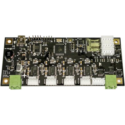

Im running a Prusa Air2 with gen6d control board (picture below)
One thing i have noticed in pronterface is when i press connect it takes +/- 15 seconds before the board sends back its info . Dont think this is helping matters.
Ive tried to set the timeout to 20secs in the Tools>firmware options > communications menu but that didnt help either
Ive also tried to cycle the power and hit the reset button ( read that somewhere else on the forum) and that doesnt help either.
Cheers
