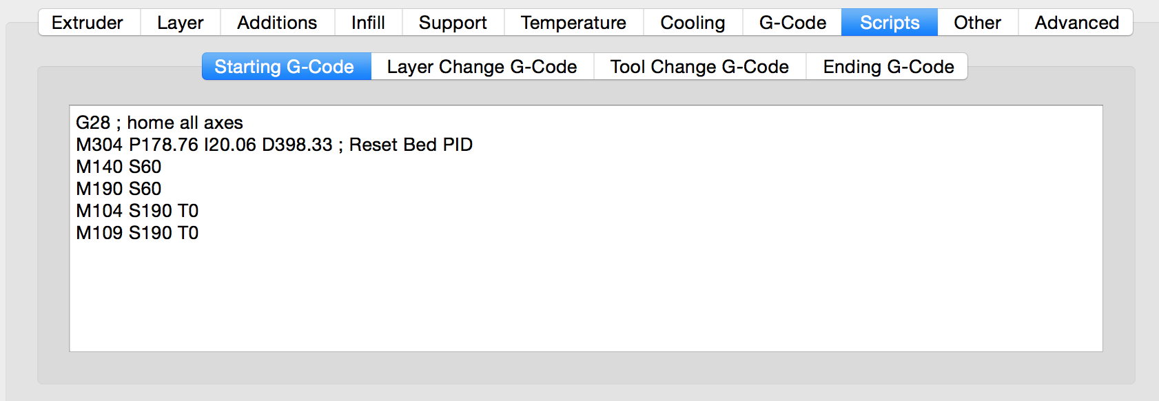

Doing what you suggested (see attached screenshot) yields GCode that sets the bed temp, tries to wait for the bed temp, adjusts the PID, and then tries to re-set and wait for the temp.
Settings
Settings
Code: Select all
G90
M82
M106 S0
M140 S60
M190 S60
M104 S190 T0
M109 S190 T0
G28 ; home all axes
M304 P178.76 I20.06 D398.33 ; Reset Bed PID
M140 S60
M190 S60
M104 S190 T0
M109 S190 T0
Am I doing it wrong?
