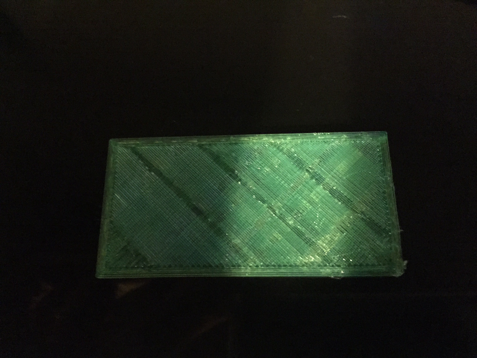

Hi everyone,
I am new in 3D printing, I just bought a printer (Zyyx) and I am trying
to use it.
I use simplify 3D to generate the print. Everything works fine but in the first layer
I have notice "holes" (see picture attached) in the structure and for some smalls prints I would like to have a solid
first layer.
I tried quite everything but I did not managed to get rid of those "holes"
Can someone tell me how to do it because I am sure that there is a setting for that.
Sorry for my english this is not my mother tongue.
Syd

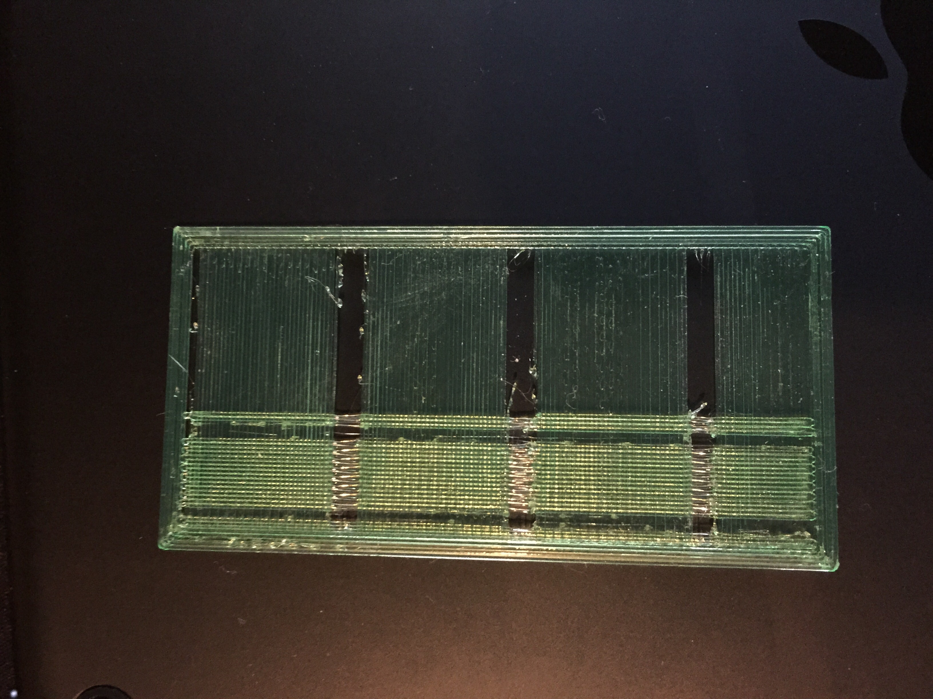

So I did another try yesterday. In that one the infill Angle are 45 -45
The factory file is attached and here is the picture.
You can see the "holes" on it. They are not random I think they follow a pattern but I am not able to find where to cancel them.
Thanks in advance for you help.
Syd

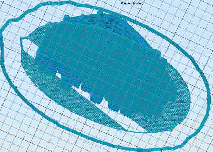

Nearly the same problem the last 3 days.
I couldn't uncheck raft without unchecking also skirt and when unchecked, S3D make anyway raft with holes.
After new installing the program it looked better, but I needed to remove the object, uncheck the box "Save and Restore ..." in Tools/Options, close the program and restart the computer; than loading a older factory-file - and it goes fine. Now check the box "Save ..."
The prints output where bad as in the preview shown.
Horst, GER

Surely. But this appearances were independent of the objects, even older objects also as import of factory-files, which were print a couple of days before without faults.
I also had tried the unchecking of Save ans Restore - before uninstalling and re-install the program, no success.
But when the object contains mistakes, what is the correlation to raft and skirt? S3D had drawn the contour correct and let open a band and / or omited complete raft base layers.
Horst, GER
Posts: 861
Re: First Layer "holes"
At the moment I have tested the same objekt 2x (not repaired https://netfabb.azurewebsites.net/ and repaired = -fixed) with the same result.
When I click to Prepare To Print without changing the position or lift up, skirt and raft are normal. But when I change the Position by turning and lifting to the table, then the preview mode shows the object totaly without skirt and raft. In all cases the boxes of Skirt and Raft are checked ON.
Horst, GER
