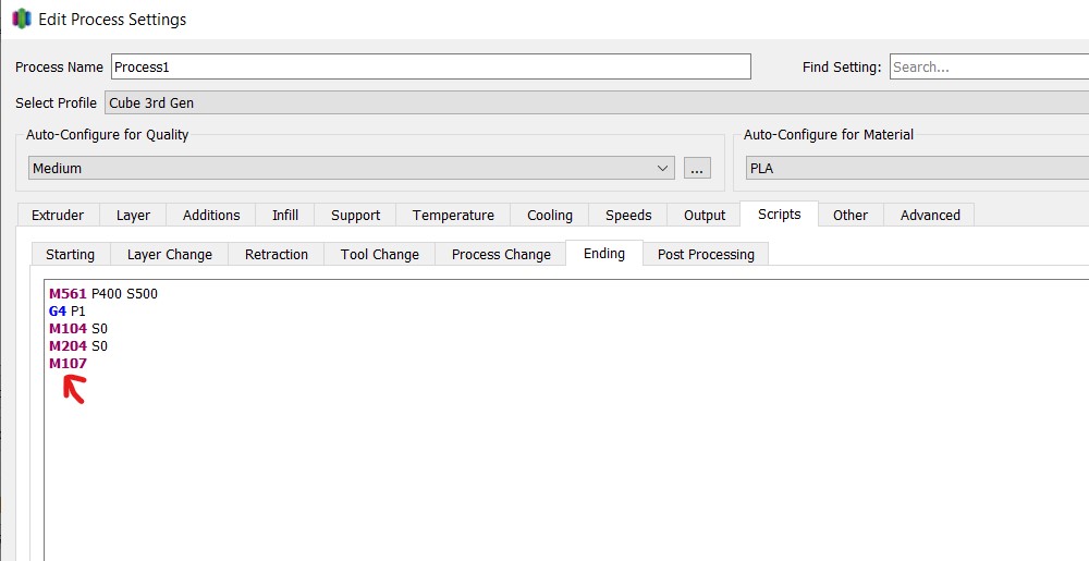

Hello, when save a print file as BFB file type S3D v5 is copying the last line of script and placing it at the beginning of the print file. This will result in an error unless you manually delete this line every time. I reported this to support email but did not receive a response and it is not fixed in the latest update.

I don't think that's related to your ending script. That's just one of a few commands that S3D usually puts at the start of each file (G90, M82, M106/M107, etc). Do you see something in your post-processing script that was removing the G90 and M82/M83 commands? Maybe you just need to add another command there to remove the M106/M107 commands as well.

I don't think that is correct. M107 = turn fan off. Is there a need to issue this command at the beginning of a print file, when the fan hasn't bene turned on yet?
The following commands are stripped by the profile:
{STRIP ";"}
{STRIP "G90"}
{STRIP "M82"}
{STRIP "M102"}
{STRIP "T0"}
{STRIP "T1"}
{STRIP "T2"}
M107 being placed at the beginning of the print file is a bug, new to V5, and should be easy to resolve.
