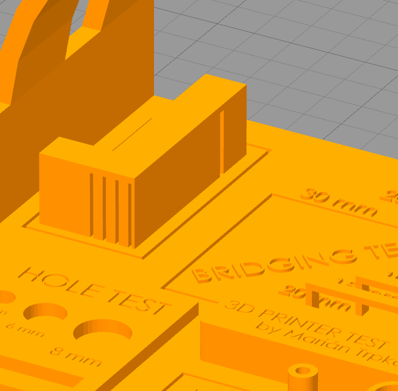

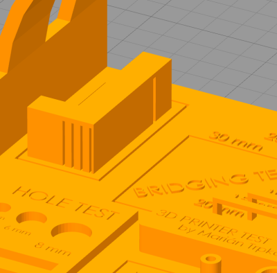

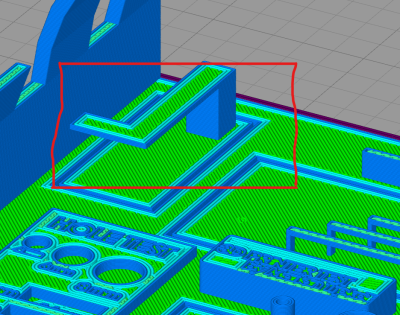

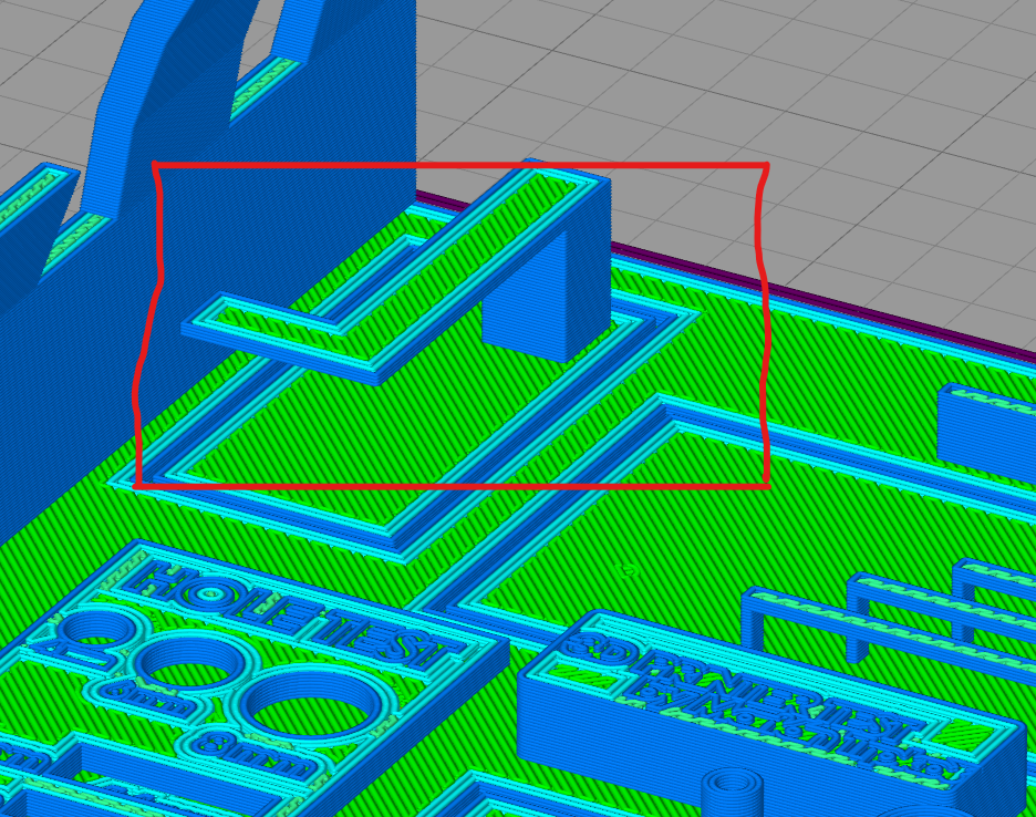

I'm experiencing some weird slicing behavior. Before slicing the model seems fine. After, a par of the model is gone???
I have uploaded 2 pictures where you can see the problem.
Anyone have a clue where to start? I have sliced it once before and it turned out fine. Can't figure out what's going on now.

Pre Slicing
Pre Slicing
Post Slicing
Post Slicing

Did you already try the suggestions in this article?
https://www.simplify3d.com/resources/ar ... sh-errors/
It explains how to check for any issues with the mesh, and how to use different repair modes at the bottom so that you can still process problematic files.
