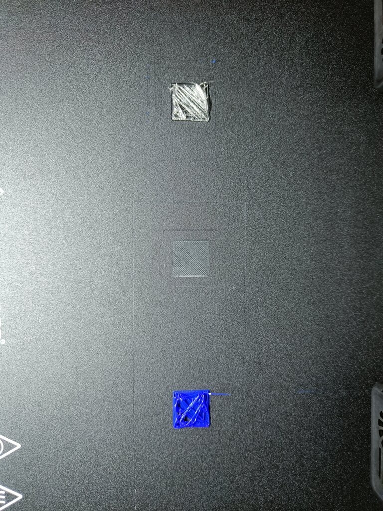

Mirror and copy mode doesn't work on the Flashforge Creator 3/ 3Pro.
The machine act really weird with printing triangles on a square piece, skips layers and it jitters alot.
The multi material part is still working as it did in V4 but the two other modes doesn't.

Do you have the Creator 3 or the Creator 3 Pro? What firmware version are you running?
I know we've used both mirror and duplication mode on our own printers without issue, so it will help to know a bit more information.

I have the Creator 3 Pro and the firmware is: 1.3.7 103 VC1.2.5 20220427 read directly from the machine.
Also Simplify creates two files and i use the .Gx file not the G-code file if that helps.

Are you able to post the exact .gx file that you tried to print? If you run that file a few more times does this issue happen every single time?
