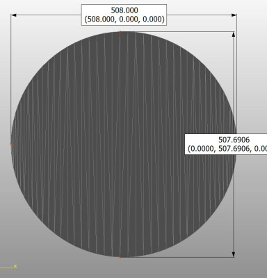

I have an stl exported from Sketchup that has a diameter of 508mm
When i bring it into Simplify 3d version 4 and click on the model file to get dimensions it shows 508mm in the X size but only 507.69 in the Y size direction.
Untitled picture.png (5.99 KiB) Viewed 2399 times
Would this not mean that i would not be printing a true circle?
I can scale it independantly to get it right, but I would think that a circle at 508mm would be 508mm under both x and y.
Can anyone explain why it would give me a smaller dimension in the Y axis for a circle?
Horizontal size is turned off in the slicer and this works out to a 0.06 percent scaling error in the Y-axis.
I have attached the stl I am loading into the software.

ve3sjk wrote: ↑Mon Feb 12, 2024 5:16 am I have an stl exported from Sketchup that has a diameter of 508mm

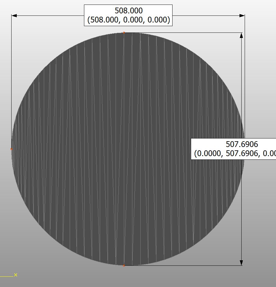

Because depending on the quality settings your objects will be segmented. There's no arcs
or circles inside STL files.
...I highly recommend checking out what horizontal size compensation is for.
Seems fine. S3D will tell you the size of the bounding box. And that's 508.0 x 507.69 because
of the segmentation:
