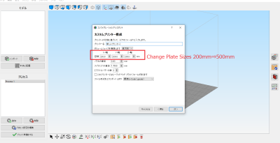

I couldn't get the screen recording to work, so I'm sending you a screenshot.
I am trying to change the Plate size from 200mm to 500mm.
However, it hasn't been changed.
Re: Custom profile changes are not saved
Odd... I don't think we've seen anyone else have this issue. If you click "Edit Process Settings" and try to change other settings like layer height or extrusion multiplier, so those changes save successfully?
