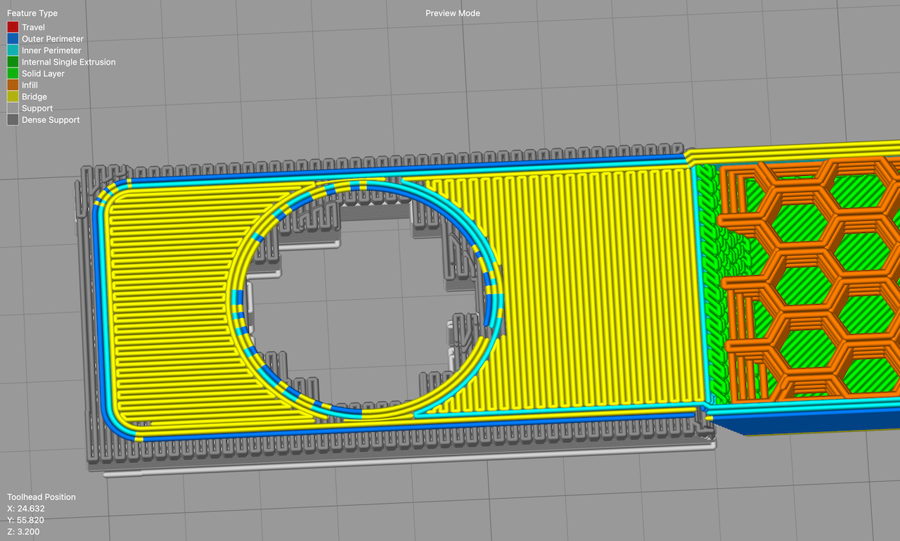

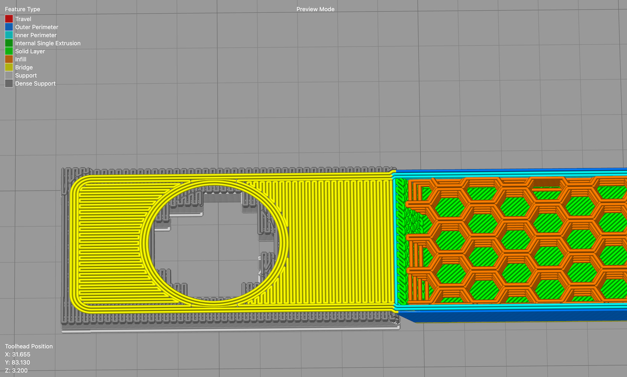

I have the issue that with "coast at end" enabled the perimeter bridging does not properly work and randomly generates normal perimeter segments instead of bridging perimeters. When it is deactivated the bridging does work as expected. Is there a fix available or suggestions?
enabled:
disabled:
