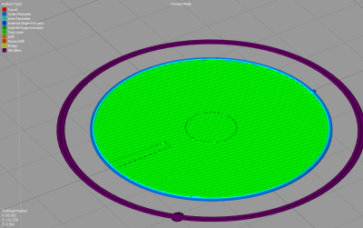

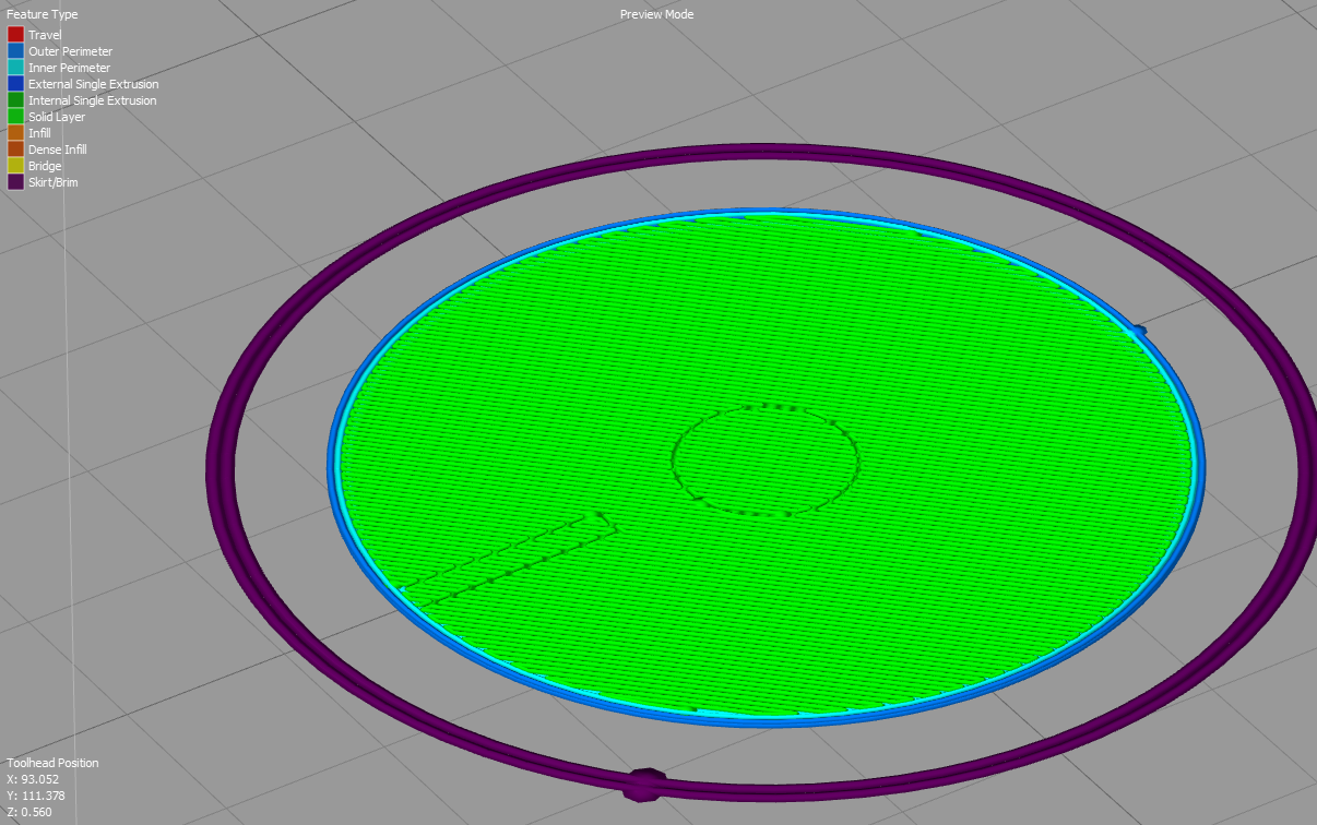

I want to print a single layer thin sheet with some geometry on top, But instead of it printing a continuous initial layer it cuts it where the geometry lays on top, Any help would be appreciated.

Increasing the value of Top Layer Extra Expansion should solve this. The post here explains a bit further: viewtopic.php?p=74471#p74471

Nice this helped
