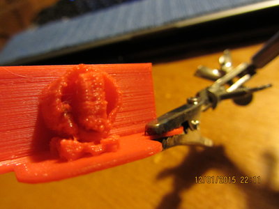

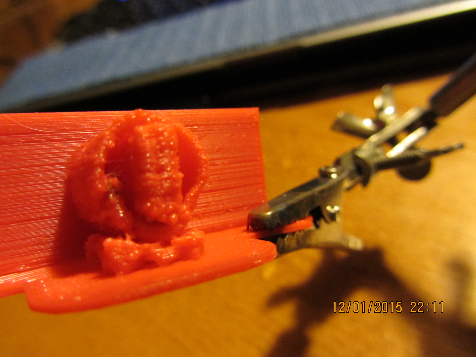

I have a problem with manuell support, what ist looking through the object. Unfortunately it is print out like it looks by preview.
I took the pictures in re-proceeding the bad print. The object is drawn with VIA-CAD and controlled by https://netfabb.azurewebsites.net/
Horst,GER

I see that occasionally as well. Usually I get around it by moving the support or changing the size of the support. It's definitely a bug.

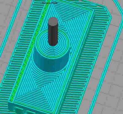

There is another dubious problem occured.
Trying the print in a turned position so that the holder-tube ist standing upright, the preview shows the hollow construction filled up just to the top. The print is now running but I have seen that it prints like shown.
The construction with VIA CAD ist only a ring pull up as the tube wall and there is no doubt about that the object is hollow.
The factory-files for this print is attached.

horst, in the advanced tab uncheck "merge all outlines into a solid model"
Posts: 861
Re: Support ist looking across the object
BINGO! ... for the 2nd problem so I can print now on this position.
Thanks
Horst
Note: this option has only effects in the upright position but not in horizontal direction; thats right so ???

I have seen that before where the support hoes through a wall. It doesnt happen often, 1 out if a hundred, and i dont really know the cause. Just a strange glitch i guess. Try to use manual support and maybe reduce pillar size and delete the ones giving you trouble.

that is the manuell support and it comes every time in a characteristic angle of 45 up to nearly 90°, related to my selfmade object.
But you are right, it doesn't appear when the pillar is narrower than 4 mm. With 1,2 and 3 mm nothing happens. But the print of such small support-pillars is really difficult.
Using manuell 3.5 mm pillar it appears only near by 90°.
Using the automatical support I have never seen it. But using 5 mm and changing from 45° to an angle of 30° by cklicking the button "Apply based ... " has also effects.
H.
