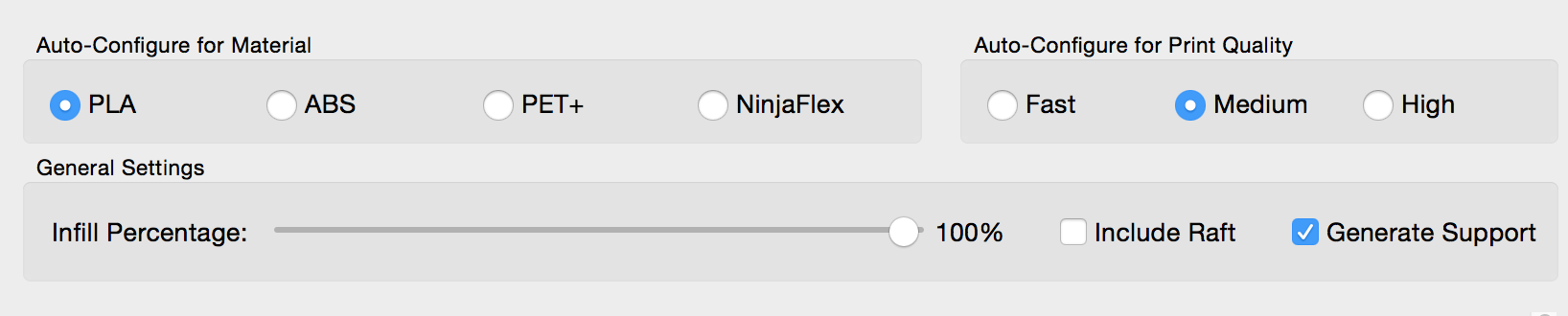

A great thing about editing printer profiles, is the ability to go in and customize beyond what the software allows for. For instance, in one of my profiles, I've set it up so that there is a preconfigured button for NinjaFlex material and PET + filament as well.
To edit your printer profile and have customized settings for the auto-configures, click Edit Process Settings, and then use the Export button to Export a .FFF printer profile. Then use a text-editor to open this file (Notepad, Notepad++, TextEdit, etc). Once the .FFF file is open in a text editing program, scroll to the bottom of the file, where the auto-configures are stored. They are stored in XML format, and very easily configurable.
