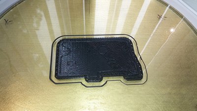

See the highlighted setting
In V2.2.0 you could adjust that to increase the gap which V2.2.1 will only do 1 layer PLUS that gap now.
Nothing to do with bed leveling, my entire bed is within +/-.003"(delta printer)

Parts curling - why I'm using them, it solves that problem.
I only print in ABS.
