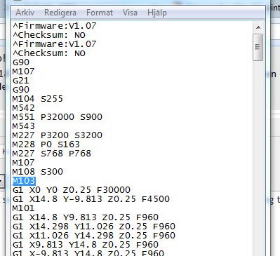

After trying to read the difference of the code I found that on row 18 it says M103 witch means "Turn all extruders off" and when deleting that row it starts to print like it should.[img]
[/img]
But I just cant edit that row in Notepad, then the printer cant read the file anymore.
So how do I edit the setting in S3d so it dont writes that line?

perolalars wrote:After trying to read the difference of the code I found that on row 18 it says M103 witch means "Turn all extruders off" and when deleting that row it starts to print like it should.[img]
[/img]
I have the M103 there on my bfb files and they work fine for me. I don't have double Firmware and Checksum header though, I don't think that should be there... I would contact support, they helped me get up and running before the latest update with the BFB profile, but with the newest update and bfb profile, I pretty much slice, save, and print without any modifications.
