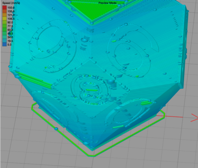

One thing I did notice when inspecting the gcode is that S3D is (at least in this one part) placing some of the infill the outside, which would explain the odd very long "blobs". They're the green lines in this screen shot:
Using version 2.2.2, but consistent with what I saw earlier.
