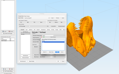

After importing and aligning the skull as two separate meshes (one for the skull, one for the shower nozzle) I have to define the processes.
I will define one process for the skull and one for the shower nozzle. The only difference between the two processes will be infill density, and they will be applied to each part separately, as shown:
- applying a process to each mesh individually

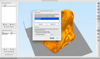

Once I click "Prepare to Print," I select both processes and continuous printing mode.
- Prepare to print...
