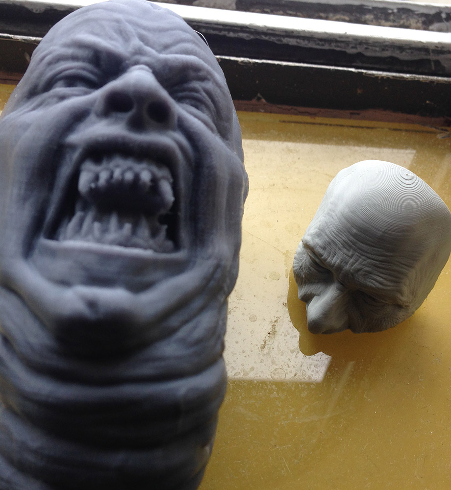

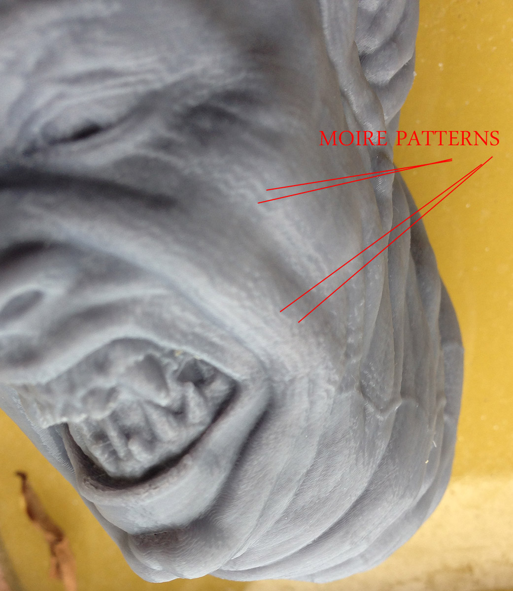

My printer is a Dremel Idea Builder, which is a rebranded Flashforge Dreamer with a few modifications. Overall the prints I have been getting are really nice, but I'm occasionally finding pretty noticeable moire patterns when running certain models at medium to large sizes. What is interesting is that when I print very small and detailed objects this moire is MUCH less noticeable and sometimes completely absent. All of my tests have been at 100 mircons and basically use the same overall settings in terms of speed, etc.

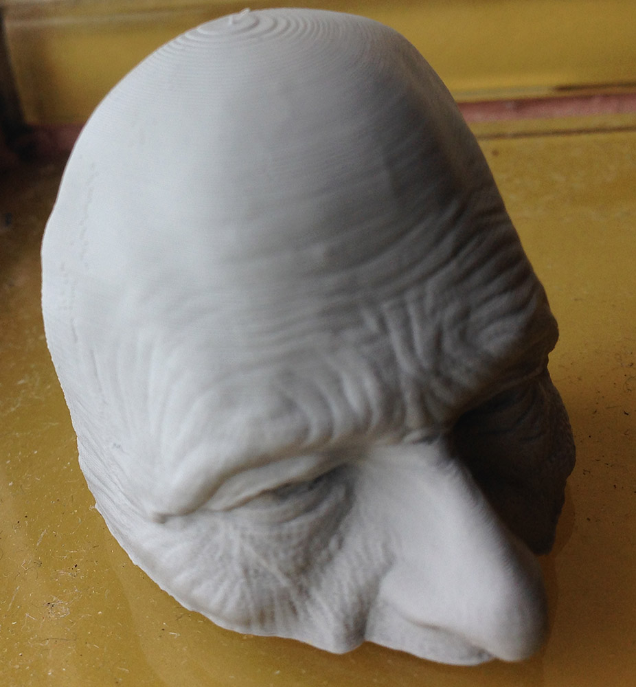

Here are some photos showing the effect that I'm seeing. In the darker model you can see some wavy interference patterns that are absent in the smaller scale test. I have to wonder if the transport doesn't get a chance to get moving at full speed in the smaller print due to the short paths before direction change.
Print exhibiting the moire artifacts
Smaller print showing no moire
Size comparison
Size comparison
Size comparison

The effect appears to be what is referred to as "ringing" in the 3d printing community. It is due to rebound in the toolpath movement when changing directions after doing a high-speed move. The momentum is not dissipated enough by the acceleration settings on your firmware.
I'd say you aren't seeing it on the smaller prints because with such smaller line segments to print, it never reaches "critical speed" to have the rebound ringing.
I'm not familiar with your hardware, but if you can tweak any "jerk" or "acceleration" values, try lowering the jerk value at first, as well as the acceleration value. The jerk setting specifies the minimum speed that the toolpath will jump to before applying acceleration (or deceleration).
