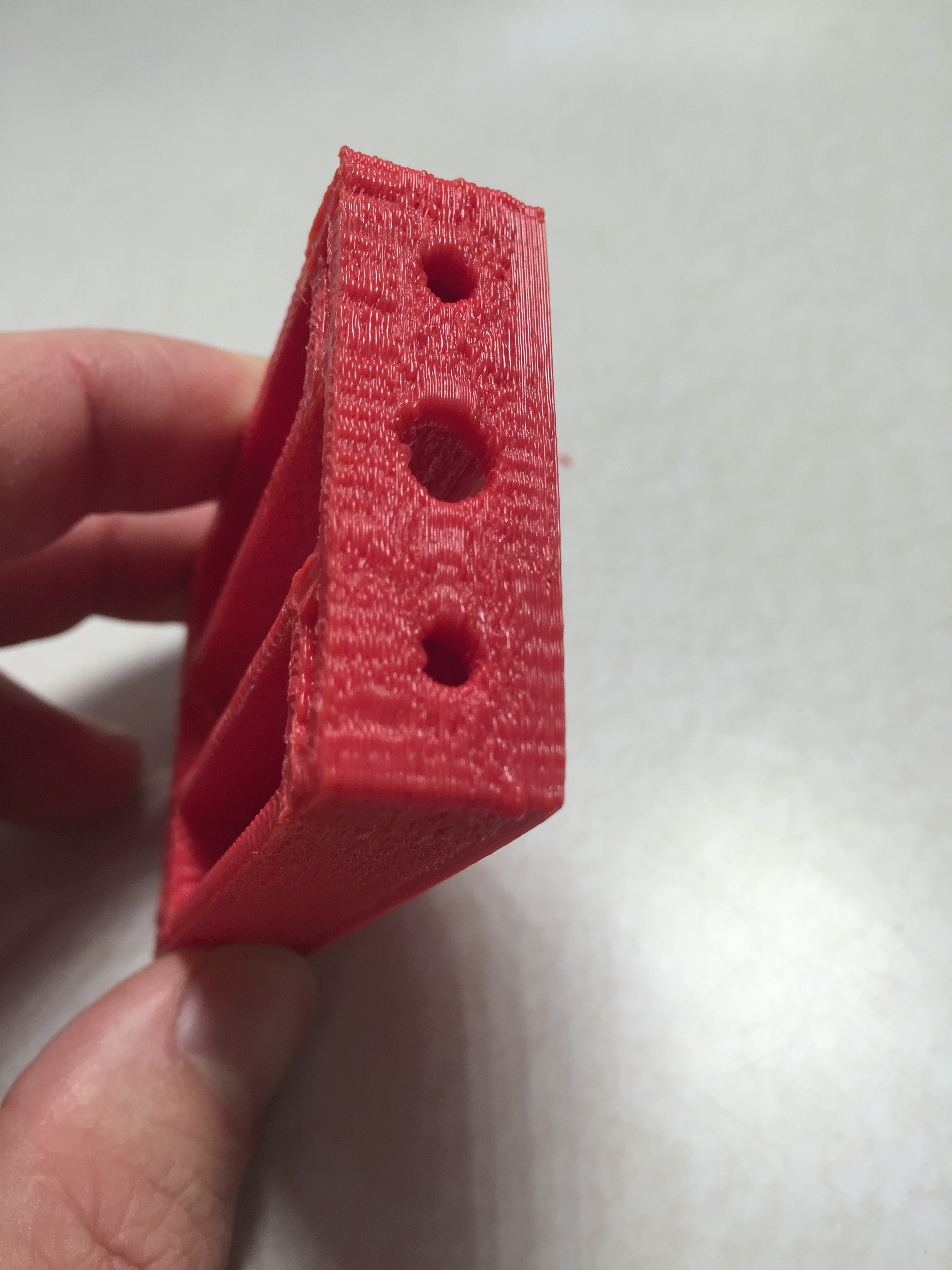

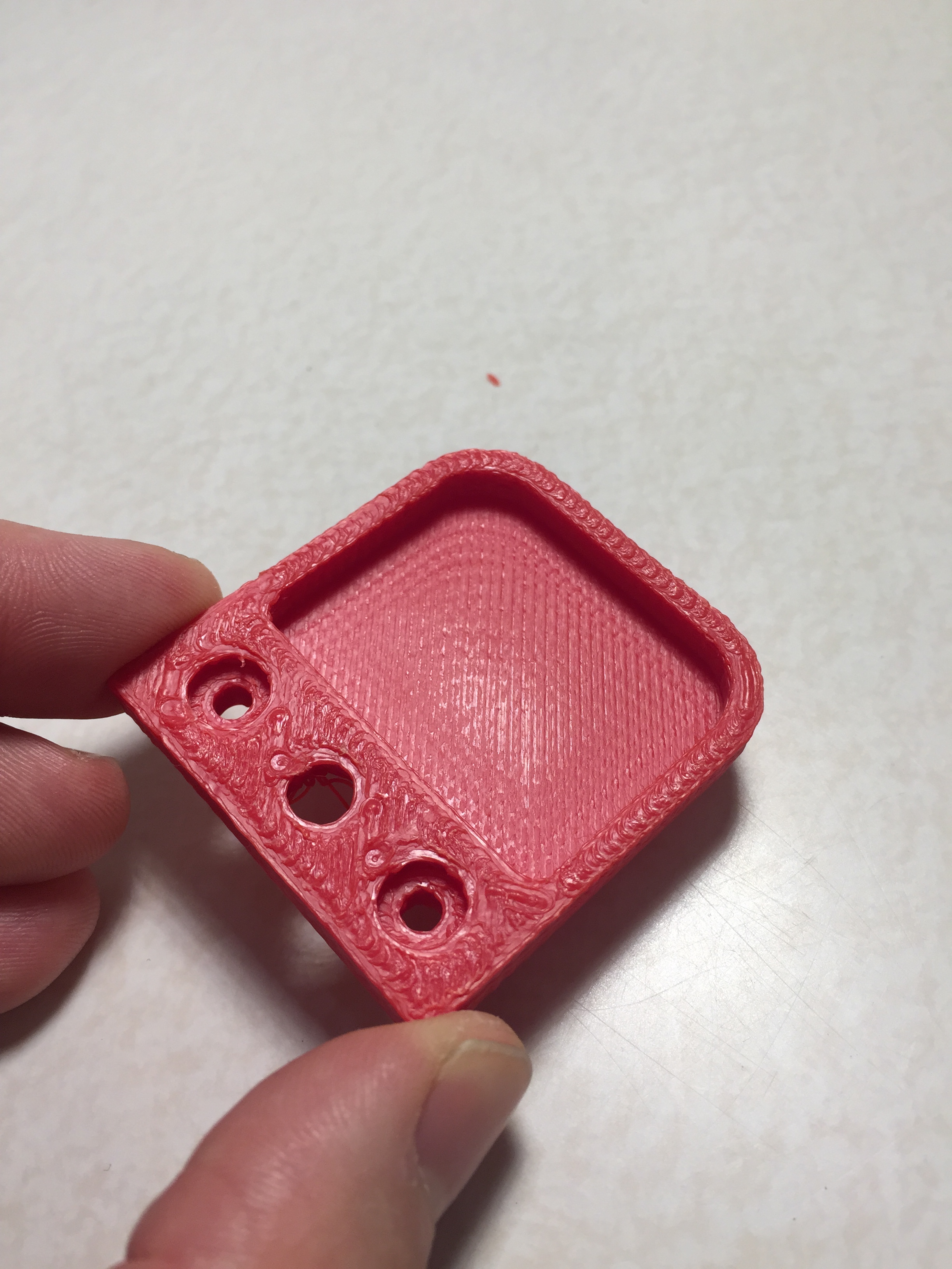

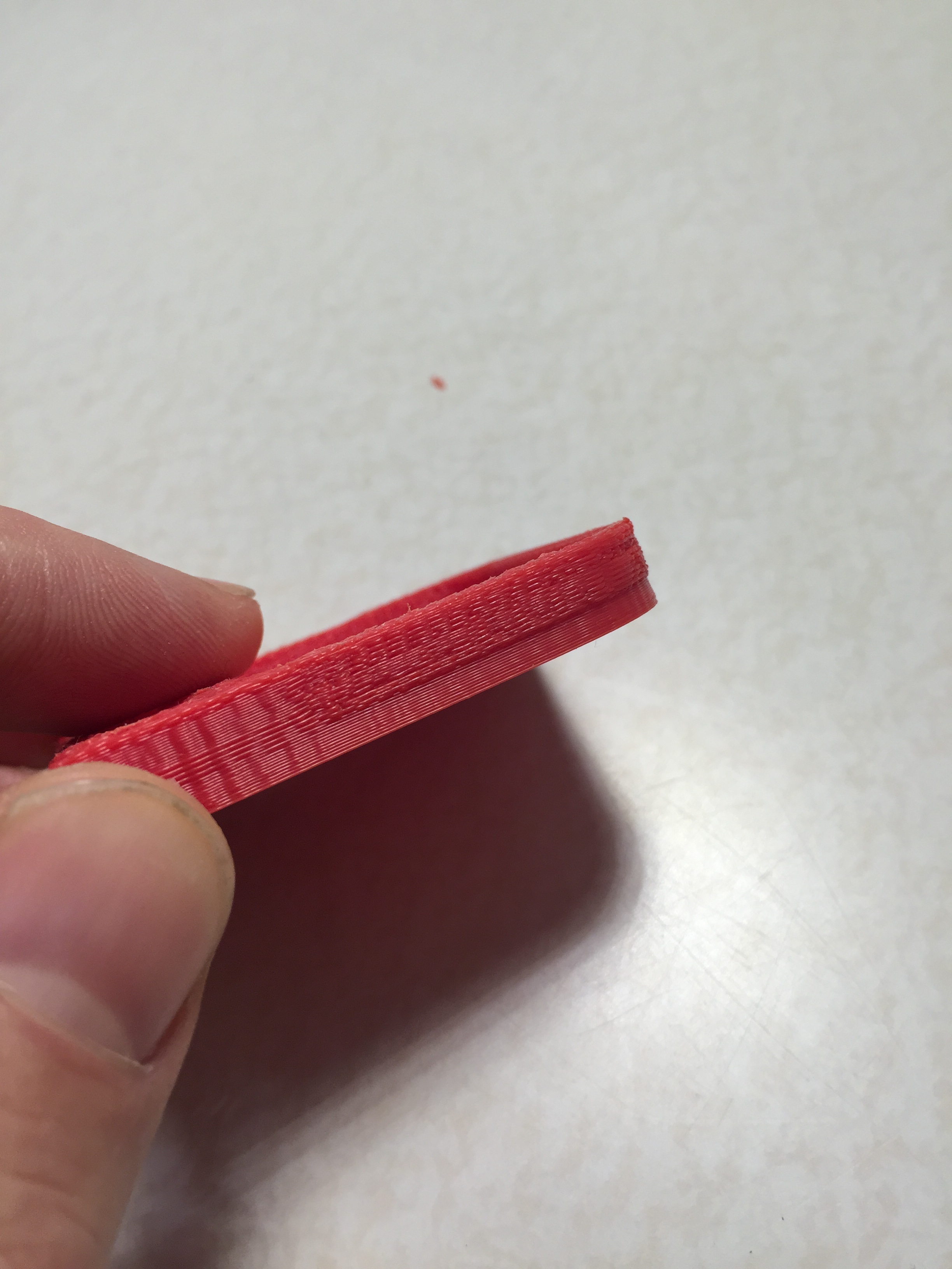

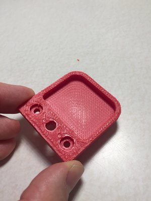

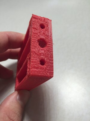

Much better! Right now it looks like the machine is just making too big a stroke when filling walls, resulting in some spill-over. Probably because the head has such high inertia.
Also the finishing layer looks really "goopy". Could this be because we're extruding at 265 instead of the normal 225 for ABS?
Any thoughts on the GCode posted above this?

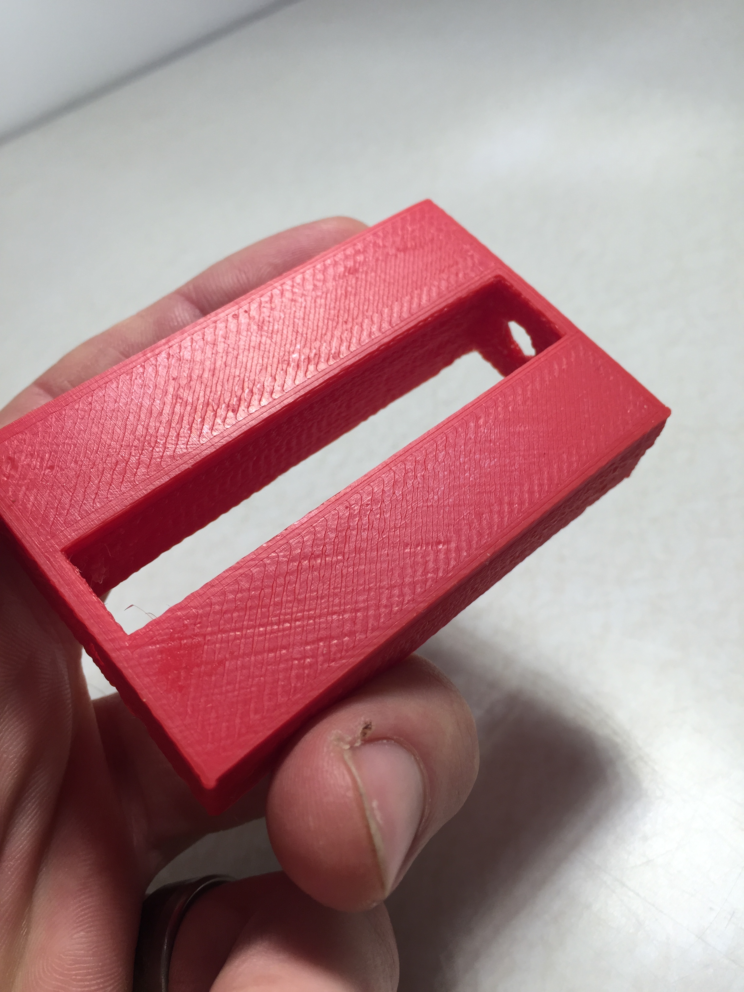

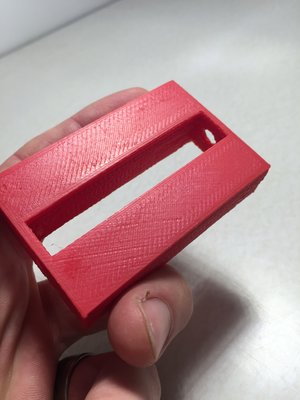

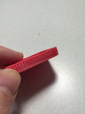

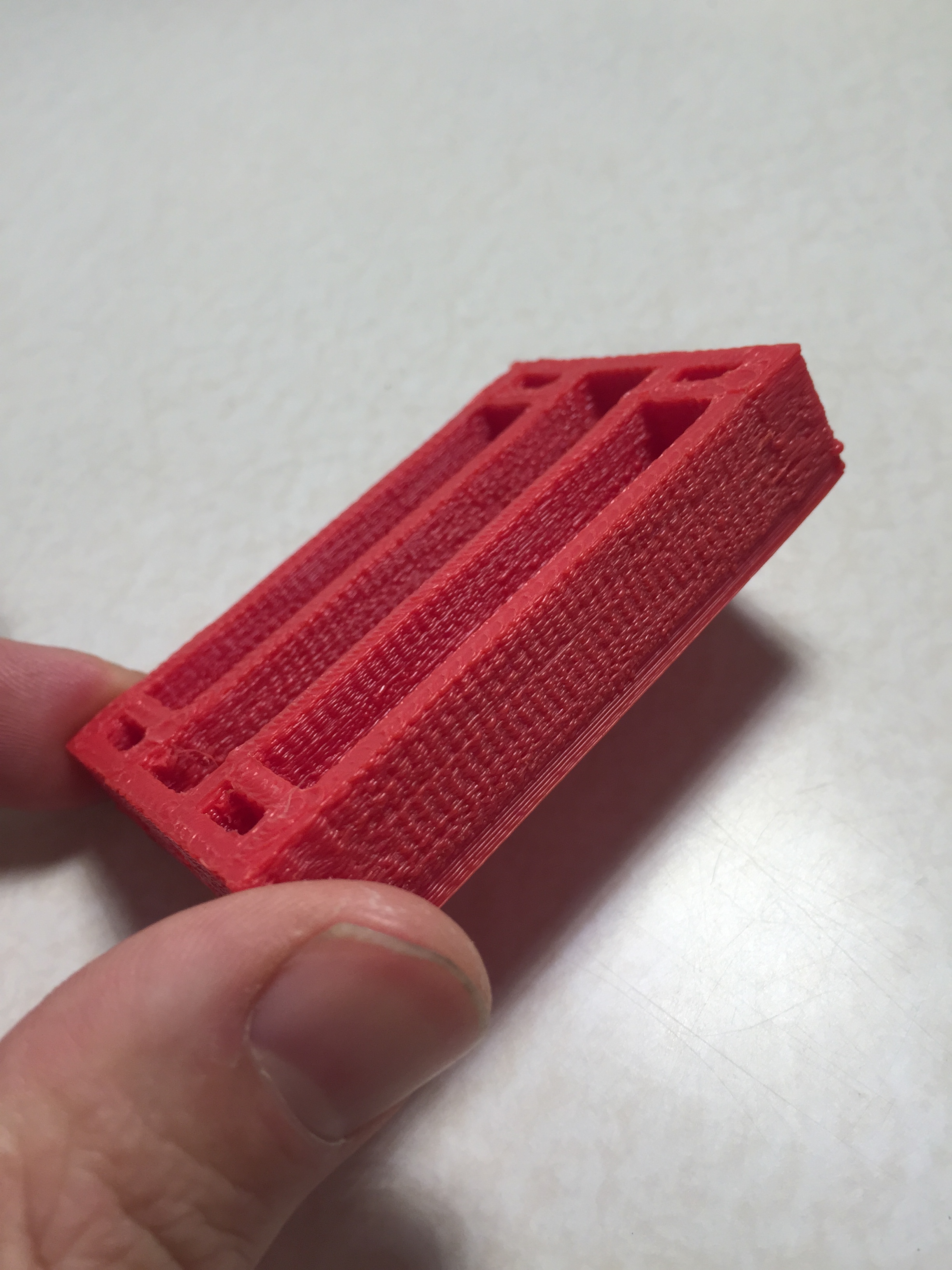

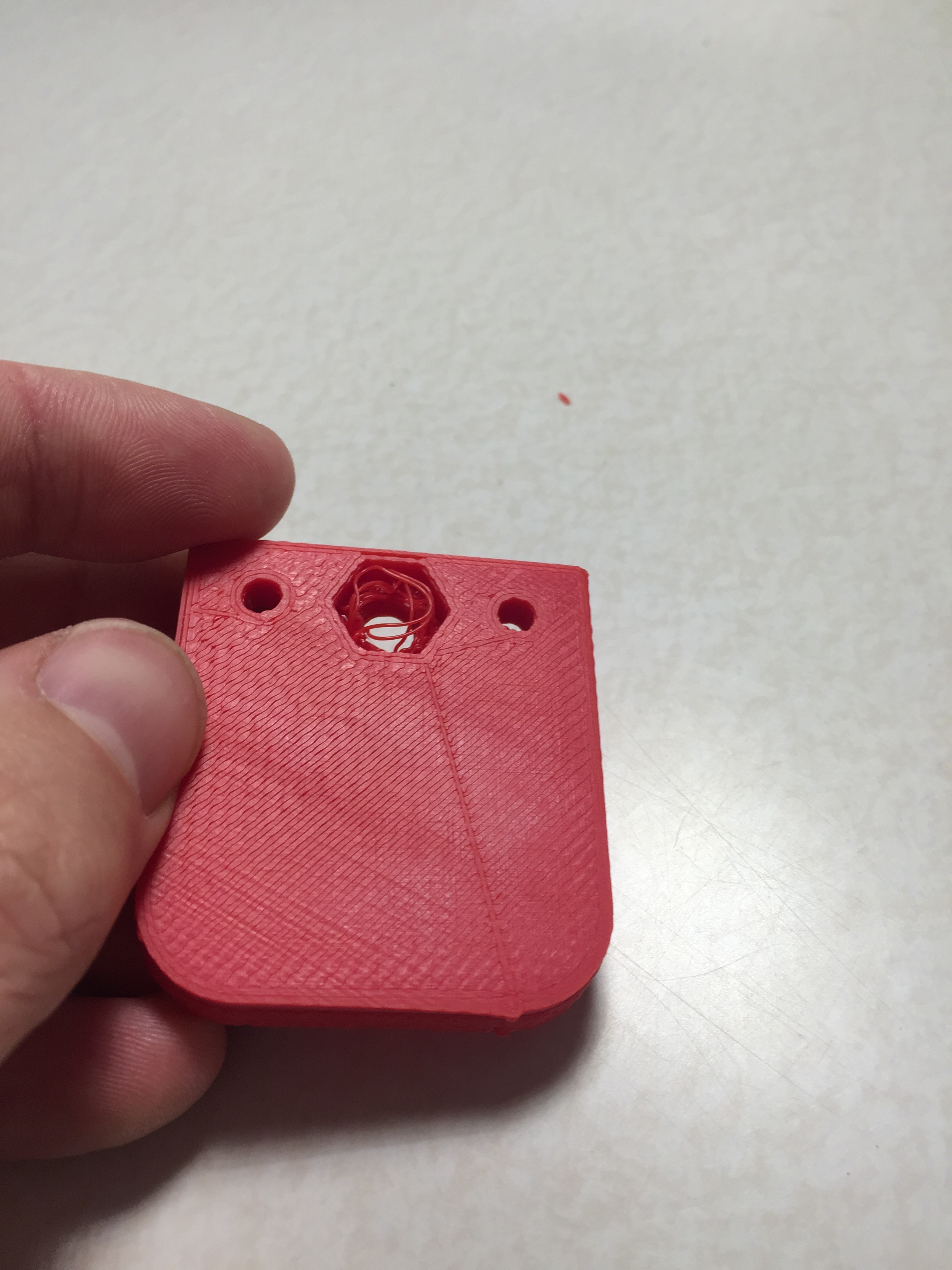

And more pics.

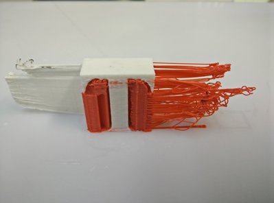

I am having issues with what appears to be nozzle offsets or something. Single head prints are fine, but dual head prints position the 2nd nozzle over the waste bin and prime the 1st nozzle into thin air. On dual head prints, the offset is also present. It wouldnt be a problem but its extruding at the time!
I cant see the offset in the gcode, so its either in the firmware or something else.
