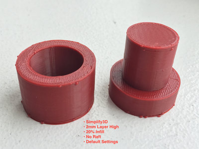

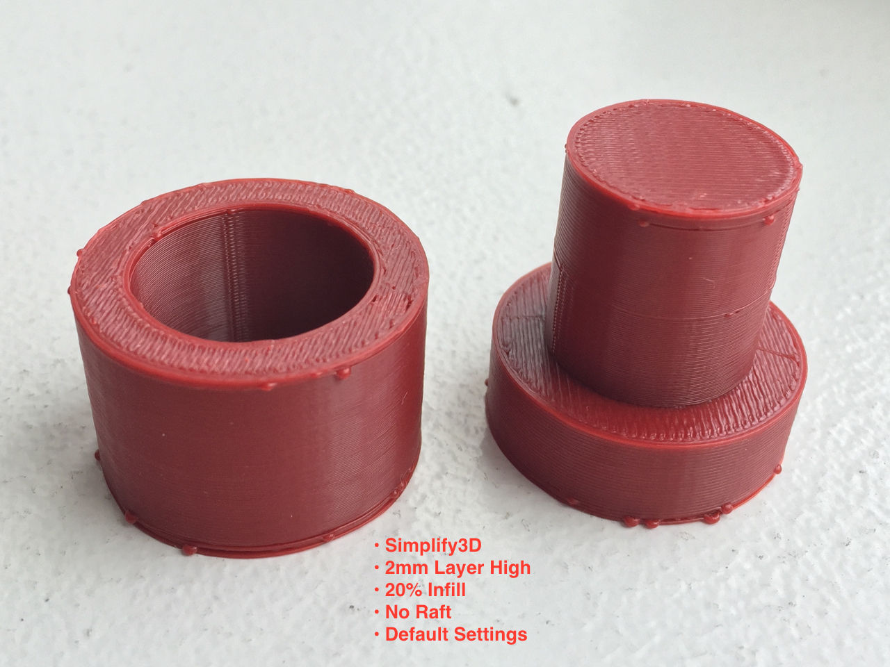

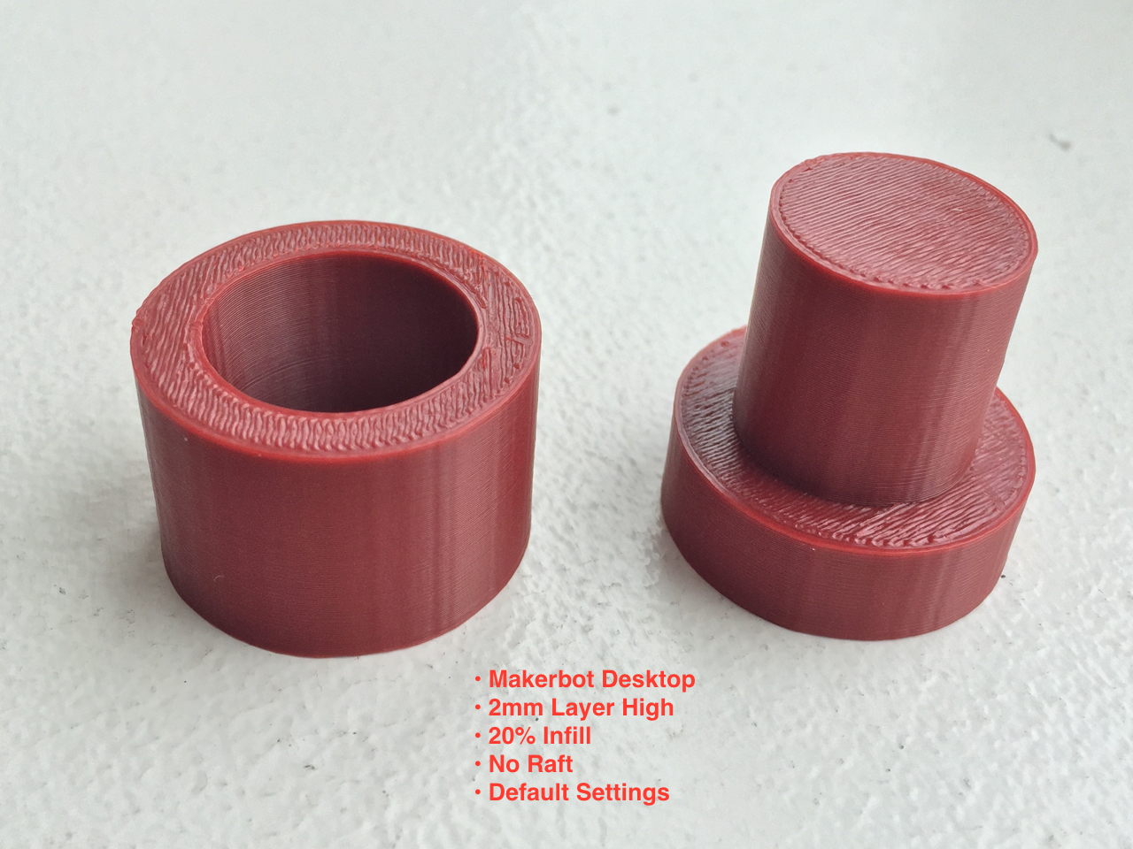

My Replicator 2X is having no issues with your factory file other than one print jammed on me but I was keeping a close eye on it so I didn't waste too much time. I'll attach some pictures of the final print below.
did you attempt Help --> Reset All Settings?
