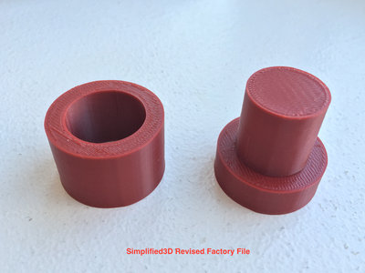

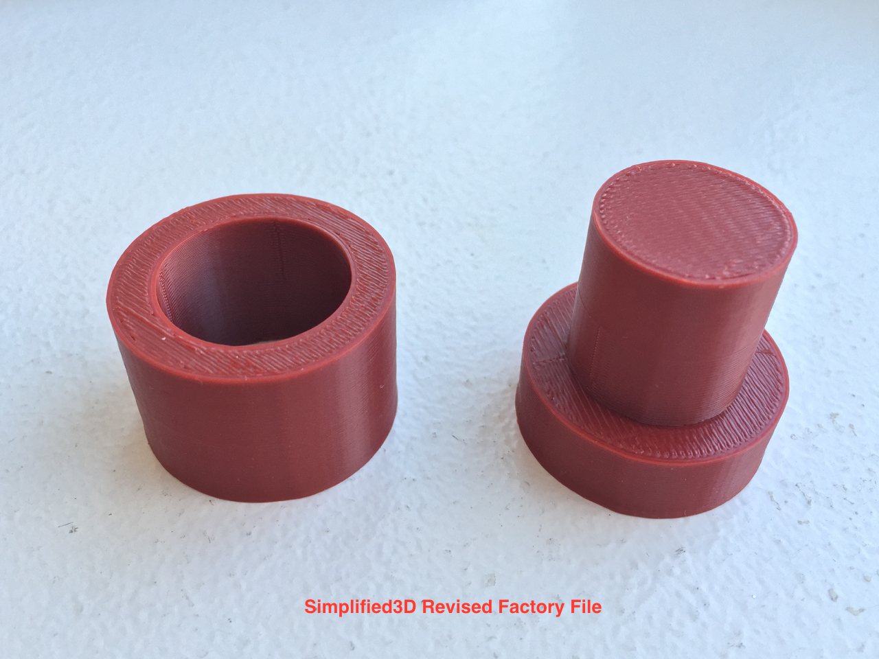

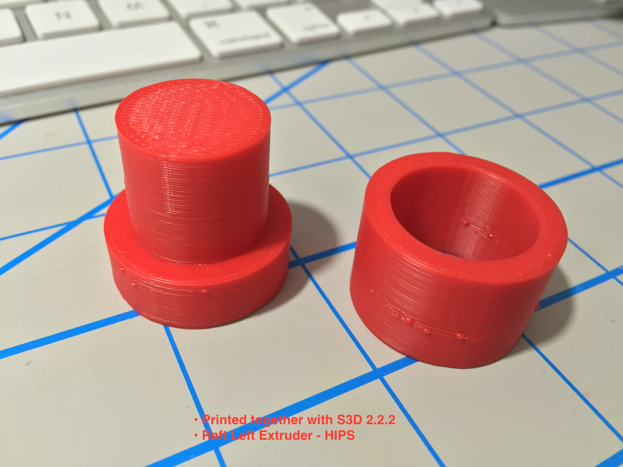

Thank you all for all the help. I printed the cylinders from a factory file sent to me by S3D.
As you see, the print came out perfect! I have to say this is the best surface quality that has come out from the Rep 2X.

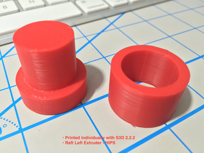

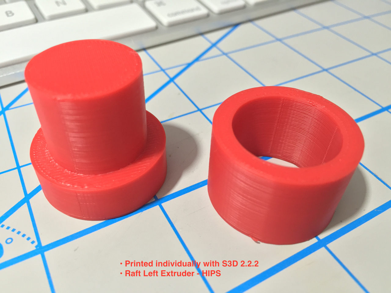

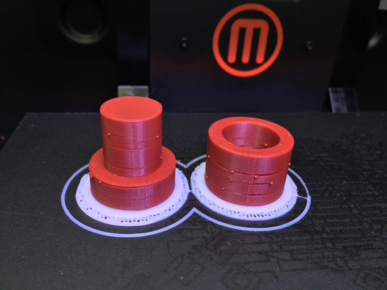

Have you tried a dual print with S3D? I typically use HIPS and ABS for all my prints. It seems that selecting the "right extruder" profile is fine, but printing with the "both extruders" profiles always gives the bubbles on the surface.
I looked into the default profiles for dual extrusion from MakerBot. The Retraction Distance is set to 1.3 and the Speed to 1500, which I changed in S3D. This profile set to "both extruders" in S3D always prints with bubbles on the surface. Using the default "both extruders" profile "as is" never prints anything, i.e. no filament comes out due to nuzzle jam.
The bubbles shown in the picture below is because both the X and Y axes stop for a few seconds while the feeding continues. This only happens when printing with S3D using the "both extruders" profile. It does not happen with Makerbot Desktop of S3D "right extruder" profile. It does not happen with S3D set to the "right extruder" profile.

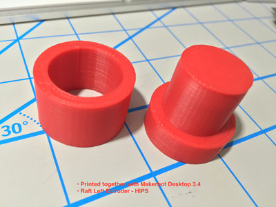

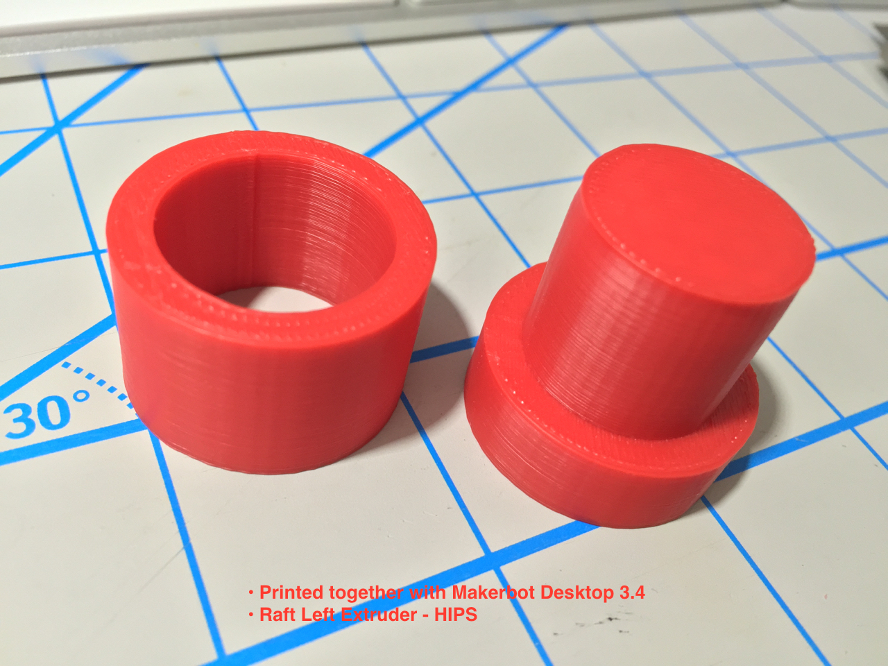

Update: I narrowed the bubbles problem to when printing both objects using the left extruder for the raft and the right extruder for the object. If I print each object individually, the print comes out perfect.
I'm using the default profile for Rep 2X Both Extruders.
Also, notice how the MB Desktop print has some ripples on the surface, but S3D does not.
