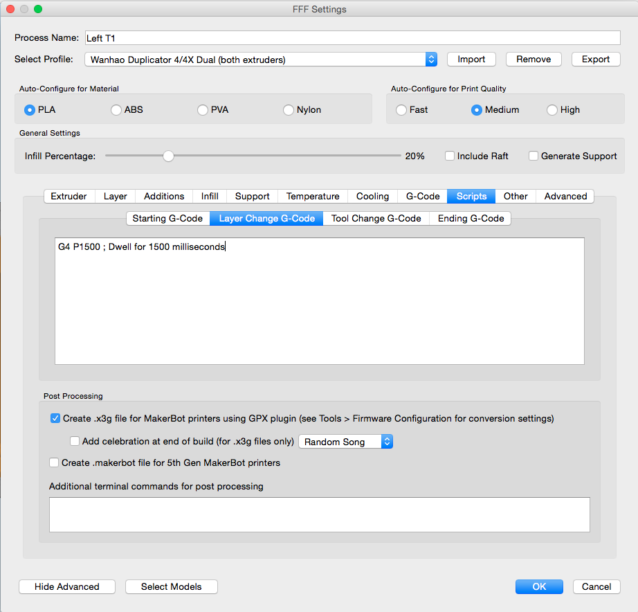

This could be solved by keeping the layer minimum times OFF and adding a layer change Gcode that pauses for a few seconds.
Scripts tab --> Layer Change G-Code --> G4 P1500 ; Dwell for 1500 milliseconds
Hope this helps. :D
